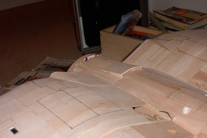

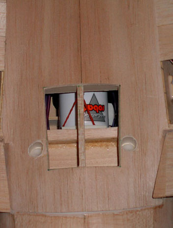

Corsairs have a window on the bottom of the fuse between the inner flaps. I'm looking for suggestions on how to do this. I'm not going for "exact scale", just "approximately scale". Any ideas?
Here's a picture of where the window is supposed to go. I already cut out the 3/32" sheeting in the bellypan where it is to go. It's dimensions are 2.5" x 2.75". The kit is a 1/8 TF Corsair.
In the picture, the nose is up and the tail is down. The two mounting bolts directly to the left and right of the window, and the inboard ends of the inner flaps are on the edges of the picture. Inside the window you'll see the a stringer running vertically (this must remain), the mounting bolt plate running horizontally, and the TE spar running horizontally. Further inside is the retract air canister. And if the angle is just right (not in this picture), you can see daylight from the canopy. Again, I'm going for approximately scale here.
How do I do this?

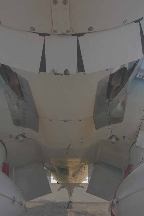

For your reference... here is where it is located in the full size Corsair (Marine's Dream). It's hard to see from this angle so I shaded everything around it for emphasis.

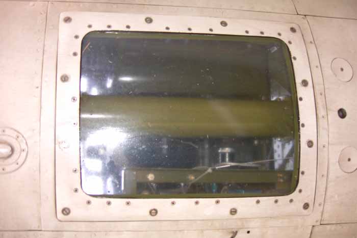

Here's a close up of the full size window.

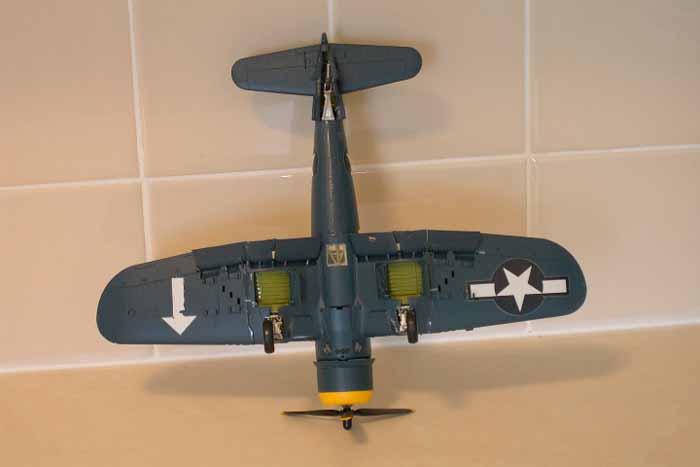

And just to get you sick of all my pictures... Here it is on my 1/48 Tamiya Corsair.

I believe that in most cases, the window was painted over on the full scale ones during WW II. It would not have been of much use for carrier operations. I will check my reference books when I get a chance to confirm this.

You could try importing your picture into a paint program, resize it to the size of your cut out, touch it up, print it, laminate it, then stick it to some thin (1/16) plexiglass. Then mount the plexiglass in your hole.
This should look close enough to the real thing to pass a cursory inspection.

According to "F4U CORSAIR", "in detail & scale", "PART 1 XF4U THROUGH F2G" (Aviation Publication/ Bert Kinzey):
"F4U-1s had a window in the lower fuselage, but it was rectangular in shape rather than being oval shaped like the one on the prototype. This window was on some early F4U-1As as well, but it was deleted during production of that variant. The windows were painted over on some aircraft, and they were not considered useful (Vought)".
From my other references, it is difficult to determine, as most photos are not of underside AND it is usually too dark when they are. There are some scale drawings which show the windows on F4U-1Ds, but I have found other errors in those drawings and therefor cannot trust them to be accurate. From eveything I have seen, I can say that they were definately not on the later models, anything later than a -2. I think some of the full scales flying these days had that window installed, just as they have installed windows aft of the canopy (usually dark blue tint) so a passenger sitting behind the pilot can have some visibility.
A detail that I think would not only stand out, but also be guaranteed to be make the aircartf more scale, is the addition of the engine compartment exhaust 'scoop' (reversed scoop) under the fuselage, which was in the same area as the window, only farther forward. I have seen this on some of the newer ARFs.

Juice you never did say what variant of the Corsair you are modeling? Your Tamiya model is painted and appears to be an F4U-1D without bomb racks, it never had a window, so the model is wrong. The window was installed on all F4U-1's and some F4U-1A's. It was basically worthless so it was deleted. On the field if a Corsair needed a repaint or repair it was just painted over. No F4U-1D's had this window.
If you still want it just cut the plastic oversize as it is in the full scale picture. Recess the wood to the thickness of the clear plastic, and glue it down with RC56 glue. When you mask for paint mask the area of the plastic that you want to remain clear, as the full scale picture. Do this after glassing but before priming.

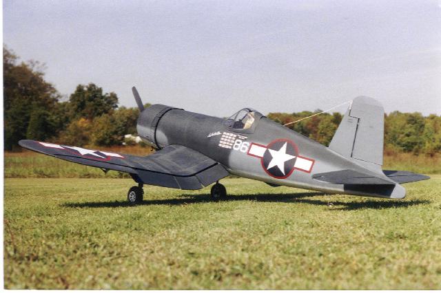

I didn't include the window in my TF Corsair but I did glass and paint it. Hope you like it.. BobH
