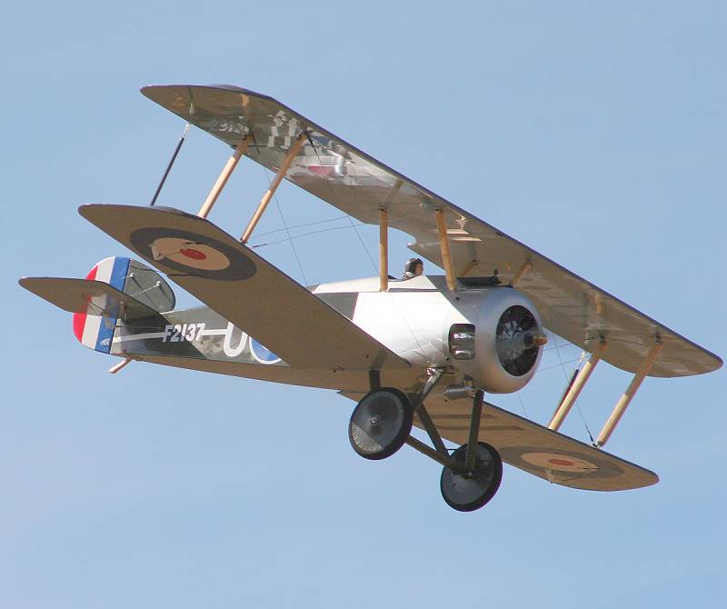

I know these have been discussed a lot, and I've read most of the threads, and I've seen just enough negative on them to make me cautious.
I've read both of Clarence Lee's reviews- the 90SP and the 120SP- and he really liked them and recommended them. He didn't have any of the problems reported by users, and the engines he tested were older versions.
I'm thinking about getting a 90SP for my Hangar 9 Camel.
I'd love to know what the "final" group opinion is.

Alan: The Hangar 9 Sopwith cowel is too small to completely enclose any conventional, overhead valve four stroke. It is, however, large in relation to the size of the 90 SP, so constructing duct work to channel the incoming air over the fins should be relatively easy. The left pic shows a conventional four stroke (Saito, I think) and the right one shows the 90 SP in the same model. Mostly, though, I like the idea of being able to turn an 18" prop, which is almost scale size for this bird.
