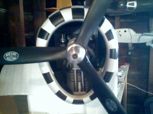

I am finishing my TF P-47 and decided to go with a pumped OS 120,which fits in the cowl nicely,my JUG has all the extras as well, including a retractable tail wheel, the extra weight in the nose helps out with balance.
the OS 91 would fly it,but you might be adding some lead in the nose to get the CG right I decided I wanted power over dead weight.
