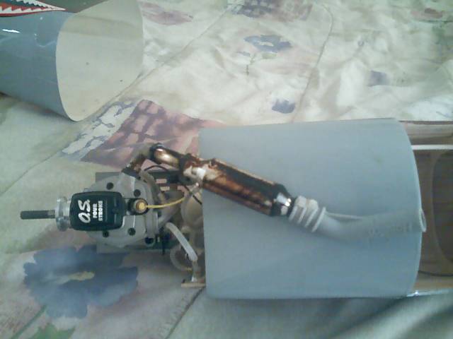

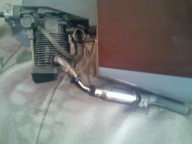

look Ma , no exits hole , great pressure and very easy to do ,
simply call Macs products , tell them your engine , he will sell you a 90 degree bend , flex pipe ect and you simply screw it on , its that simple ,

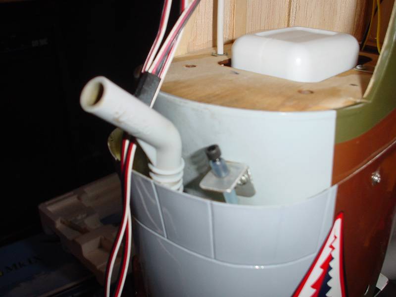

Randy if your going with a 2st 91 then your pipe selection is pretty limited to the Pits or slimline mufflers with a 4str theres alot more flexability as LDM pointed out.
there is a few threads on the TF P-40 the one by Richard Lee has some good Photos of his plane as well as some video.
here's what I did for my Hangar-9 P-40 the only thing you see is the little rubber deflector out the back,I am using a OS91 surpass.

yep that is what mine looks like with the 4 strokes , the nice thing is that you can still pressurize your tank from your standard muffler , the slimline versions on the two stroked require you to drill and tap the pressure valve , no big deal just more work
