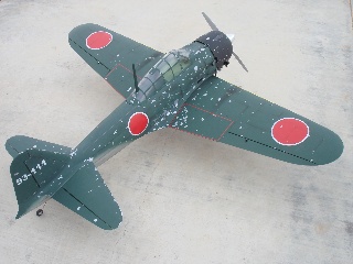

I just finished my CMP Zero 120 that my wife gave me for christmas. I have powered it with a Laser 150 four stroke and fitted spring air retracts. All markings are painted and the weathering is all airbrush.
The air reservoir is located in the drop tank together with the fill valve to save space in the fuselage (not really necessary).
The span is 182 cm (6´) and it weighs in at 5,8 Kg fuelled.
I am just waiting for some decent weather so I can try it out, and give those sorry Mustangs some whopping.

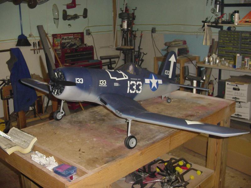

Graffen, very nice job on the weathering, and the use of the drop tank for air.
I've found another use for them also. I fly electric and looks like they would be a great place to hide the packs.
Anyhow, "Pappy" want's to know if you can come out and play?

This plane has a higher stall speed than say the World Models GS Zero. Keep the speed up on landing. Long struts also means they will snap easily so be careful. I installed flaps on the bird and found it easier to handle on landings. Keep your prop at 8 pitch to allow more control of speed for landing.
