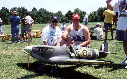

Here's Dean Digiorgio's fiberclassics. A friend bought and flew this plane at out field. Super sweet. Sold it though.

Nice plane Spit looks very well done.
