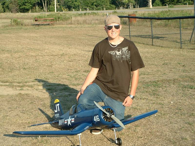

For the tracks I used windshield wiper replacement blade parts. Works like a charm and only cost me a few bucks. I think i even have some left over tracks in the shop. I'll see if i can find you some pics of the tracks on my H9 Corsair.

My son's H9 Corsair with open canopy.

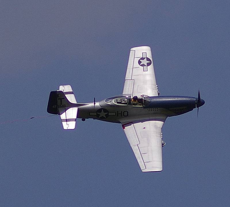

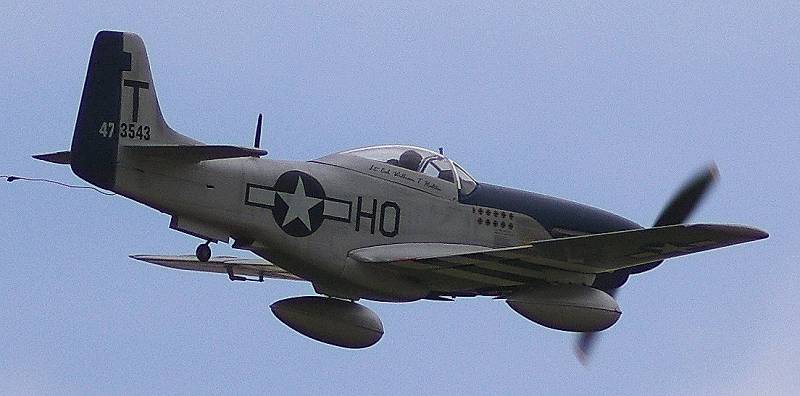

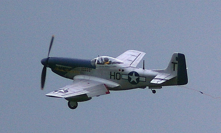

My P-51-D with sliding canopy,stays put in flight too, which is a bonus!

Matt - looks great! What scale?
