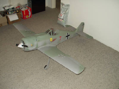

Hello
Well the hellcat is a nice plane looks good and flys nice a guy in my club as one I have the the f-190 and it flies great you can bring her in as slow as you like and thats without the flaps deployed overall there nice planes I also have the edge 540 and its will tipstall at the drop of a hat very scary to fly what motor are you putting in your hellcat my 190 has a OS 108 and it flyes allmost to fast looks scale flying at about half power

"jeffhines13"- Did you install retracts in your FW190,if so what kind and how are they holding up??

Hello BIGDADDY
yes i put robart air in mine had to beef up the formers just cut the ones out that are in there and put in some hard wood blocks pluss you'll have to dremal out the sides alittle to get them to fit but not hard just a little fiddly it now has about 25 flights on her a going good oh i also blocked up the back of the rettracks to give them more forward stans as it help it from nosing over all in all very easy to do
