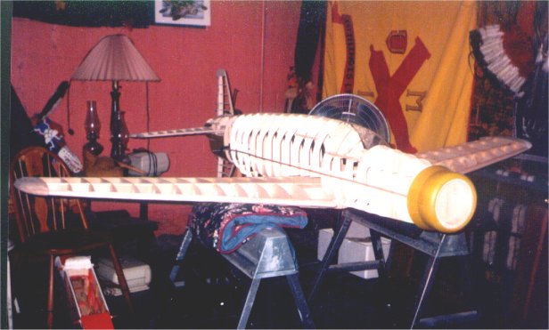

Heres a couple pics from our D0335 framed up
Joe

BTW this is the Don Smith 335

Thanks for the pics Joe. I have a much better idea of the overall size. The plans just don't do it justice. So, are you going with the Super Tigres, or are you looking at other engines? The ones I had originally consider were the F.P. or Taurus 3.2/2.6, or even Laser 300/200. Of course, they are all mega bucks (unless you have the budget for it). Also, what are the plans for the retracts? This was another of the stumbling blocks with the plane. The last information I had was that Robart was still working on the set and I would probably need to get retracts custom made. Any new word on about this? Thanks again.
Later,
Mike

Those pics are from little over a year ago he finished the plane flew it several times then he had to move so i havent heard lately how hes doing. he used i believe it was supre tiger 2500's I dont think he used 3000's but he used the supertigers. for the retracts he had robarts custom do them for him and i think they charged him 750 to make them.
Joe
