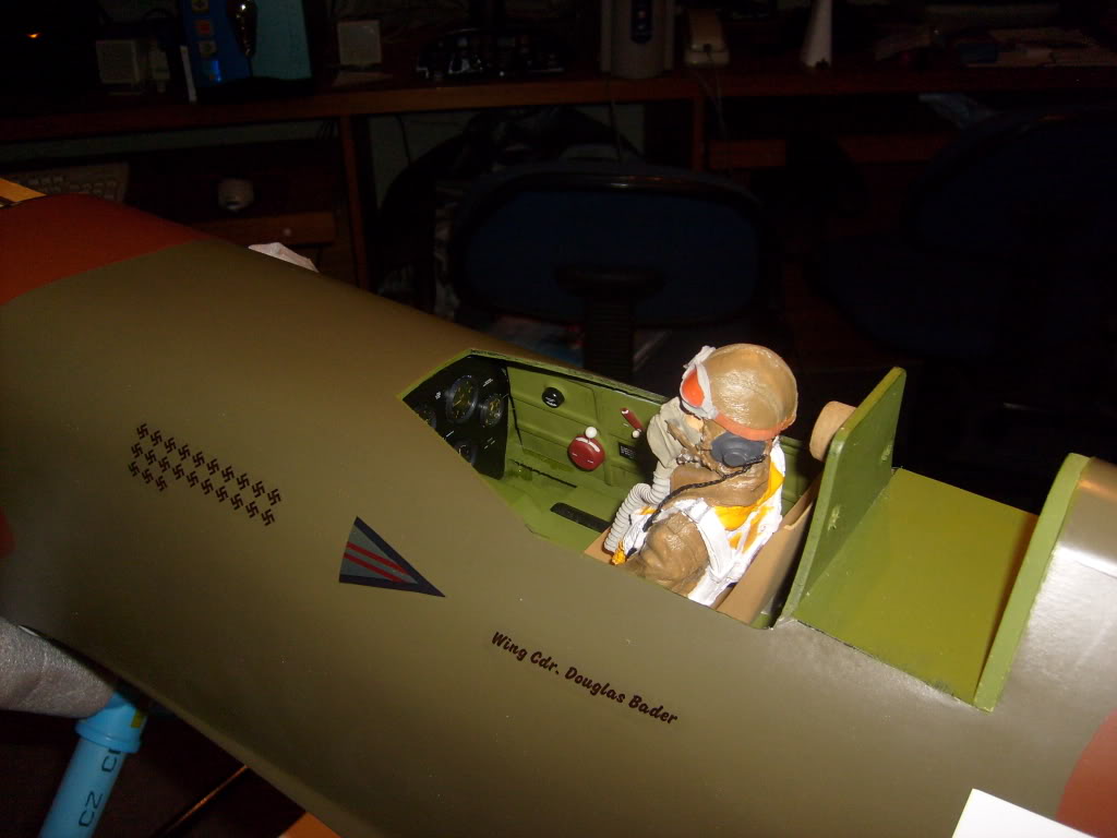

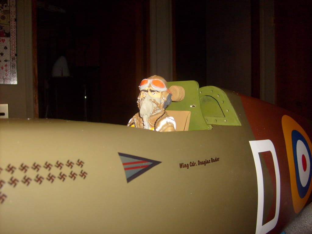

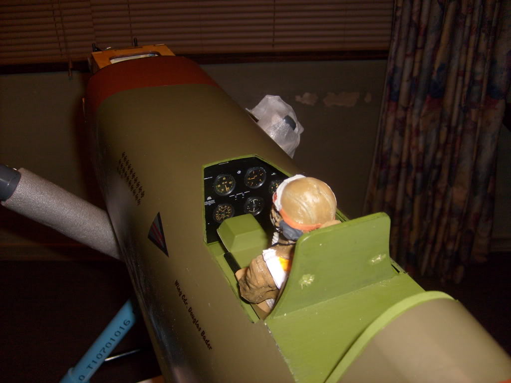

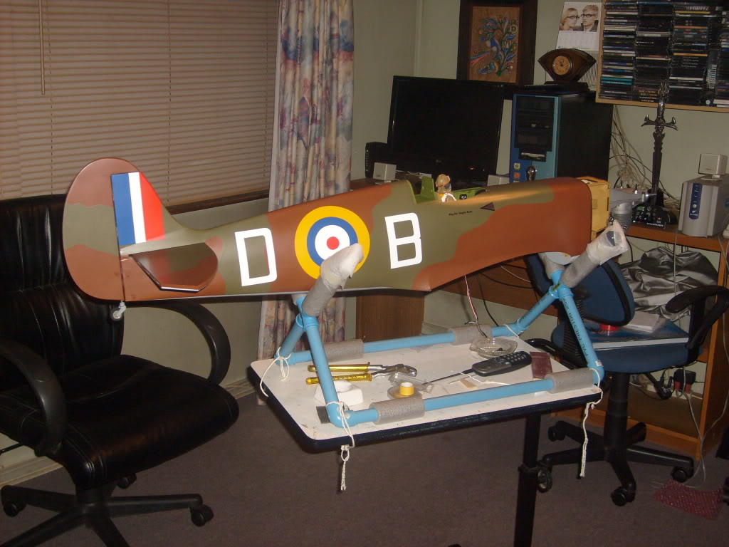

Default Spitfire Hangar 9 Scale Modification

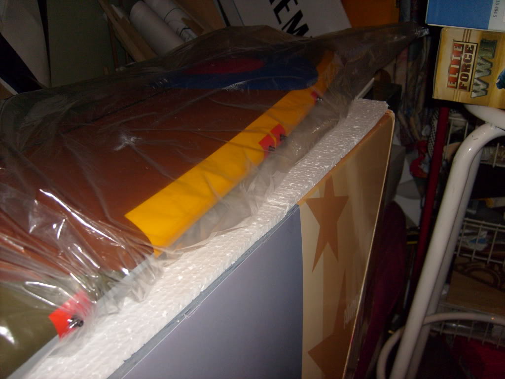

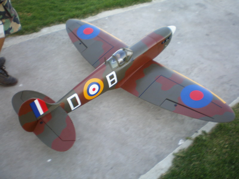

I have recently bought a Hangar 9 Spitfire ARF and i wanted to make it really good scale looking, i started by taking off that horrible glossy finish by alcohol sanding (mesh type sandpaper and rubbing alcohol) then applying a coat of Flat Clear Lustrekote, the finished thing is impressive, then i made the machine guns (8) because Douglas Bader used only machine guns instead of machine and cannons. But the most remarkable thing was the modification of the cockpit kit, i removed the floor and bought a Top-Flite Spitfire Cockpit kit, i had to modify it a little bit, i even had to put the floor the opposite way so i didnt have to cut the foot pedals, i also bought a Hobby-Lobby scale instrument panel kit for British 1/5 Scale Warbird. So anyone who has thought of modifying this airplane here is a little help.

I will keep posting on the future modifications, i will be installing a KeLeo Creations Live Exhaust
Old 10-27-2008 | 03:51 PM
Joined: Oct 2005
Posts: 11,517
From: Near Pfafftown NC
Default RE: Spitfire Hangar 9 Scale Modification
Looking good.
Where did the cockpit come from?
And what pilot is that?
Old 10-27-2008 | 03:54 PM
zephyr0908's Avatar
Joined: Aug 2007
Posts: 16
From: Santiago, CHILE
The pilot is one bought from HP Pilots, it was painted by a scale modeler, the cockpit is the TOP-FLITE for the MK IX version

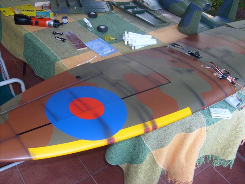

Old 11-13-2008 | 09:12 PM
zephyr0908's Avatar
Joined: Aug 2007
Posts: 16

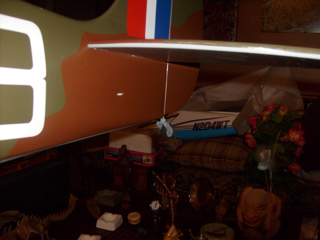

Thank you very much Stuntflyr, this is what i did to dull the candy looking ultracote covering, First i started by sanding the entire surface with a 600 grit sandpaper so it scraped the glossy layer of the covering, then i cleaned up the surface with rubbing alcohol, i dont know what isopropyl alcohol would do to the covering so i used what i knew would go perfect. Then i sprayed a light coat of Lustrekote Flat Clear, you have to wait for a reasonable time to handle the wing afterwards.
Things you have to consider before doing this process:
Make sure the covering is very well attached to the wood and that its well shrunk
Make sure you dont have to put any more layers of covering afterwards
If for any reason you have to re-shrunk the covering do the following
Get yourself an aluminum plate, i use aircraft grade aluminum because its the one we use on the university, and with a heatgun (NEVER WITH COVERING IRON) start shrinking the covering making sure you use the aluminum plate to prevent heating areas you dont want to heat (aluminum is best because it dissipates heat very fast), this is the only way to shrink the covering without making damage on the paintjob
Hope this helped you

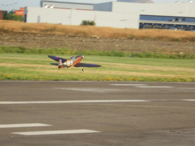

Well here is the video i promised with a couple more pictures
The video
[link=http://www.youtube.com/watch?v=EuxTNMxYlB4]TEST RUN[/link]

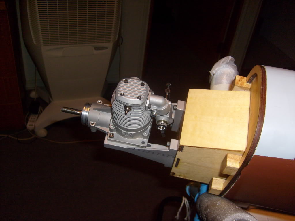

Has anyone considered putting a 20 cc in this plane ?
Love the Mods...keep up the good work~
Old 12-15-2008 | 05:18 PM
zephyr0908's Avatar
Joined: Aug 2007
Posts: 16
Flying with a .91 4 stroke gives you perfect power, i have even heard about someone that fle with a 1.25 saito and had inmense power and inmense problems with flutter, even at the point of almost losing the model, i think that 20 cc is too much for this baby and you should never atempt to do this, unless you make great modifications regarding resistance and joints

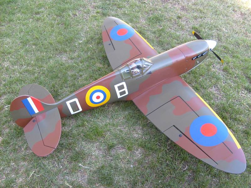

Old 05-13-2009 | 07:17 AM
0z0
Joined: Jun 2007
Posts: 64
Hi Bob, those are some pictures of the Zephyr´s Spit finished.
