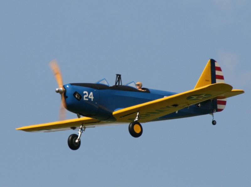

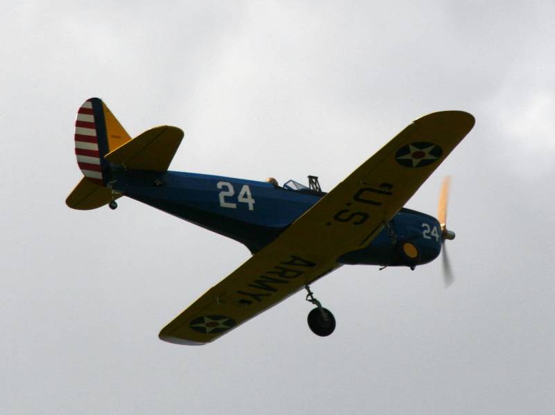

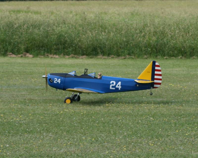

Jim, I have one of these with a G-38 turning a 20x8 prop. The prop is bigger than the scale of the plane. As the guys previous its an absolute *****cat. I have flaps on all my other stuff and with the Hugh prop disk this one acts just like it has flaps. Top speed is about scale maybe a little faster but low passes wont burn any worms.
I don’t remember what the firewall thickness is in the kit, mine is 1/2in thick. I glassed that to the light ply fuse. box structure. On the inside of that box structure I ran 1/4x1/2 pin in each of the corners running as far back as it can as a solid unbroken peace. My E and R servos are mounted right under the h stab. I cut the struts off the torque rods that cam with the kit and stuck century jet oleo’s on the stubs.
Here are some pic’s of mine.
Joe

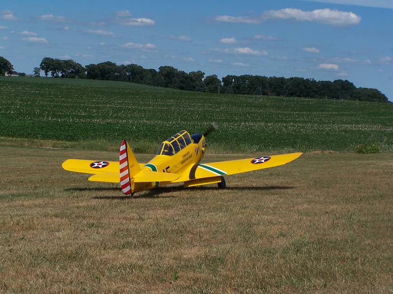

I've had 2 of these. The first flew for 3 years as a PT-19 with a G-23. Flew fine, but very deliberate. Rebuilt it as a PT-23 with a US 35cc. Flew for another 2 years. Built the second as a PT-26 with a G-26 spinning a 17x8. This I feel is the perfect engine/prop combination for this plane. I added flaps to this plane as well. Unfortunately I hit a tree in 2007 with this plane and haven't had the chance to finish the repairs.
Good luck finding a canopy for a PT-26. I finally gave up looking and made my own. It's a simple canopy and isn't too tough to make.
It also worth looking into the fiberglass cowl available from Spychalla Aircraft for this plane. Leo's glass work is beautiful and he incoporated a little more scale shape into his cowl. Worth the money in my opinion.

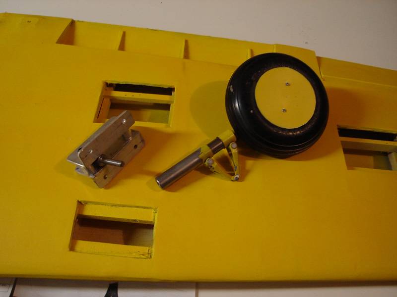

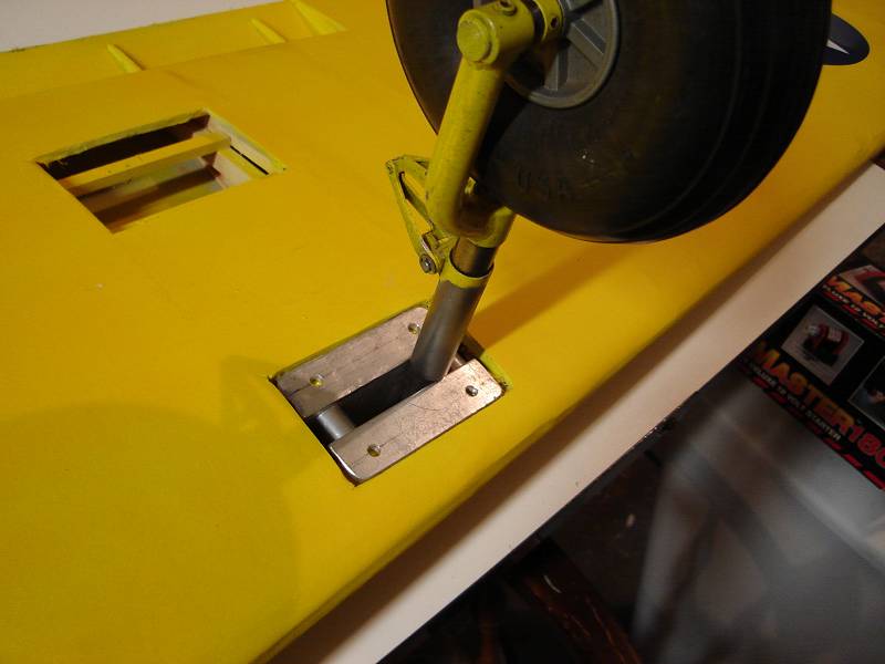

I did away with the wire mount all together. I made a bracket that the struts can mount to that mounts to the wing the same way a retract mechanism would.
