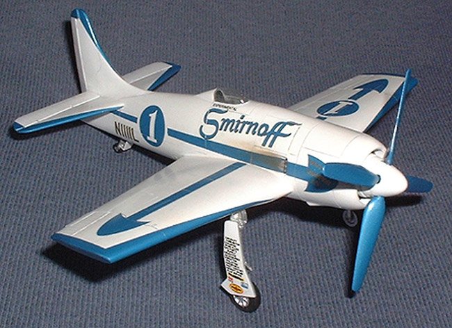

I posted on the giant scale forum but havnt received any input. Im building the Ziroli 86" Bearcat and trying to decide what to use for power. I am aware of Quiros Bearcat with a BME-102 twin but that just seems excessive. I want to fly at scale speeds, mind you the full scale was/is a rocket in vertical. No prop plane could beat its rate of climb, or short take off distance. I want the most power and compact size for the least amount of money......DONT WE ALL????
Im also considering a DA-85 or equivelent. I plan on building 2 wings-full span and clipped. Will use Robinaire or Sierra articulating retracts. I plan on modeling Darrell Greenameyers 1967 "Smirnoff" racer. The pic isnt an accurate example-the real a/c colors were a darker metallic blue trimmed in gold.
Your input and influence is greatly appreciated......
Kev

Kev, the BME 102 and the DA85 are in the same league - not much difference between them (power wise). The DA85 is a good engine with less weight and less moving parts then a two cylinder.
The DA would be a good choice for your project - keep and eye on Terry's P-40 with the 85, he ordered a 24-14 three blade - lets see how much we can get out of this baby.
Yeah the need for speed...
Happy landings
G-Pete

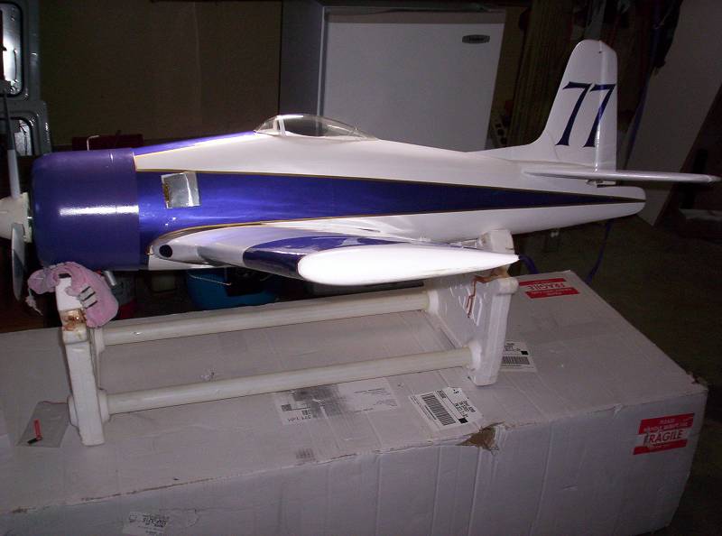

So while I collect all the scale goodies I need for for the Ziroli Bearcat I decided to "un-retire my TF Bearcat. YS-91ac for power, 3blade prop, spring air etc.... done up as Rare Bear US Thrift racer. This one scoots along at 140 mph straight and level. No nasty habits-about 100 flights so far. Built in 2001. Wings clipped to scale-I removed 1 rib each side. All I need is retracts and struts and shell be flying again.
The Ziroli fuse is next to it for comparison
Kev
Kev
The YS-91AC produces between 1 and 1.5hp depents on fuel. This gives you about 8000RPM with a 12x10 3-blade - this equals to about to 75mph. You need a 18x18 and 10HP to reach about 140MPH wind Resistance loosely calculated.
There are other factors like super sonic (prop wise), weight and size...
If you would posted a racer with a knife airfoil, 4 pounds and a Rossi engine with 21000 RPM - they make 140 mph.........fast airplane though but not 140 sorry.
Happy landings
G-Pete
