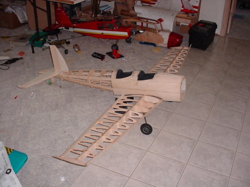

Yes, im building one right no, fairly hard to build, good wood quality, good yet sucky instruction manual.
I ran into a few of my OWN problems, things I messed up, but Id say, if ya looking at buying one, get one, the plane looks real good as its being built, heres where mines at.
