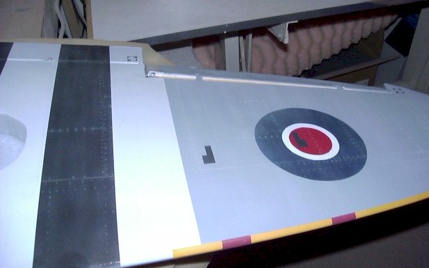

I have a weathering question as I start to weather my Taylor Spitfire. Would you streak your fuselage with weathering perpendicular to the thrust line or perpendicular to the ground when it's on it's wheels? Most color profiles seem to show it weathered top to bottom perpendicular to the thrust line, but would this look 'right' on the ground. I'm talking about the general streaking. I've done all my painting in a top to bottom motion, and on the wing in a chordwise motion.
Here is a picture after the initial steps of weathering the bottom of one of the wing tips. I'm still a few days away from really getting into the weathering as I need to finish stenciling....does it ever end!?! lol
Thanks for any input!

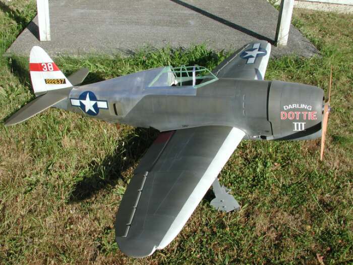

I emailed the pictures to you. The plane was painted with latex exterior flat paint. The gray and black washes were also latex. I mixed a couple drops of paint into lots of water. Basically, the washes were colored water. I used an airbrush to apply them. It took several light coats before you can start to see the effects. On the last plane I did (unfortunately I do not have any pictures) I used artist chalk to get the effects of the black wash. I like the artist chalk better because you have more control on how much you put into a panel or how wide of an oil streak you simulate. If you are applying a clear coat, do not use lighter colored artist chalk to simulate paint fading. The clear coat will turn it dark. I found this out the hard way
. The plane that I used artist chalk on crashed and burned but I still have the tail section and wing. I will try to get some pictures of the tail section and wing over the weekend and send them to you so you can see the different effect it produces over airbrushing.

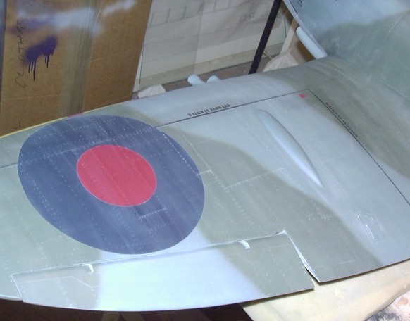

What do you think all the black weathering on the bottom of the fuse between the wheels is from? the engine? do you think it could be mud and dirt kicked up from the wheels or would that be farther out on the wing?
Ozcan,
Good tip on the steel wool. I have been using something like a scotchbright pad wiping it chordwise on the wing and vertically on the fuse.
I'm on the home stretch now....where am I to date and where am I going next? I've finished all the color paint (except the exhaust stacks) and have added the water slide decal stencils. Also have 2 light coats of clear over the decals to protect them a little from the scotchbright pad. The plane is painted so far in testor's MM enamels. I plan on finishing the sanding with the pads and then starting with the pastel dust in the panel lines, rivets etc and then using an acrylic as a wash over the whole plane. lighter in the dark areas and darker in the light areas. I figured I'd try the acrylics for this so I'm not adding almost 100% solvent to the surface...it will be almost all water. I think that will be safer.
Then i'll add some dry-brushed silver for wear, etc. Then clear coat with lustrcoat flat clear.
I'll continue to post step by step pics on my site in the projects section. I figure this project should be finished in the next week or so, that will have been 5 months start to finish.

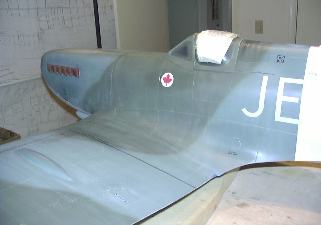

I did some more painting on the spit. I sanded it all down then sprayed on some very thinned down almost-white and almost-black...kinda tan and dark brown. It was acrylic so is was water based. I was trying to get a faded streaked look...I didn't like how the paint went on ...and I think that is because I had it TOO watered down and it just seemed to bead up. so instead of throwing the plane in the bin (LOL) i sprayed a little mist on and took a paper towl and wiped it off so that it would catch in the rivets and hopefully have a streaked look to it. I'll attach a couple pics. I think it will have the weathered look OK. When i wiped it i only wiped the wing from the front to the back...and not the back to the front. and the fuse i wiped top to bottom only. figuring that this is the way the real plane would streak.
Sean, I think its really good looking so far!... Seems to capture the weathered look real nicely.. You know where the WOD even is being held dont you?... If not.. you can go to the Delaware RC web Site and they have directions on how to get there. You can even register on-line if you like.. Keep in touch BobH.
