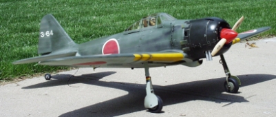

I purchased a built Royal Zero that had been hanging in a hobby shop that went out of business. It had been set up for a .60 sized engine. After updating and refitting and CG setting, the overall weight came out a little heavy(10.25 lbs. to 10.5 lbs.). I have been out of the hobby for about 15 years and too my recollection, that is a little heavy for that sized engine. I was hoping that some of you who may have had some experience with this kit can guide me on the proper engine. I have an O.S. 61 FX currently in it. Will that fly a 10.5 lbs. airplane? It does not have to be the hottest thing to satisfy me after so many years away from the hobby.
Any help that could be given would be greatly appreciated.

Wiz, I would say the 61 will fly the Zero pretty scale like.. I flew an old Pica spitfire that weighted about the same with an old Veco 60 and that has less power than the .61. Just let the plane fly on the wing and you'll be ok.. the Zero is a great flying plane.. you should enjoy it.. just keep the CG where it belongs.... Regards BobH.

I have a 60 size Focke-Wulf 190 A8 that weighs 11 lbs. 2 oz. Its wingspan is only 60 inches, yet it flew with an OS 61FX, even at half throttle. It was pretty quick at full throttle. The take off run was fairly long, however. Like Bob said, you have to fly the plane on the wing, not on the prop.

I've got the Marutaka Zero (same kit) but still NIB. I won't be building it anytime soon. Let us know how it flies. Sure looks nice! More photos would be appreciated as well.
