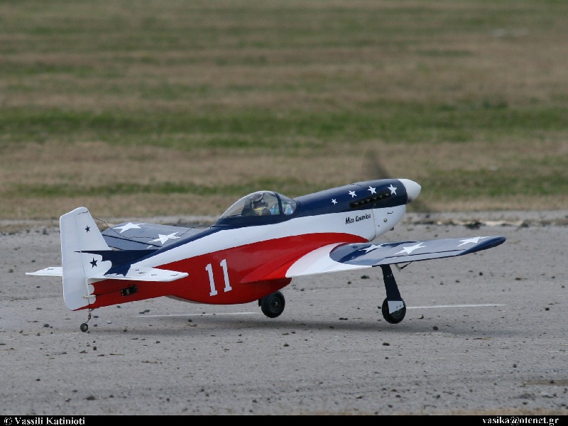

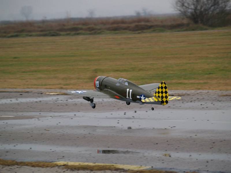

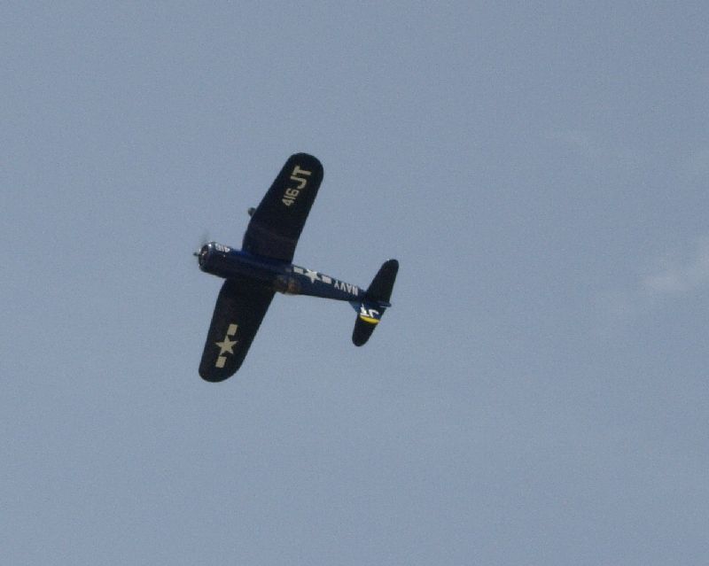

Hey skippyspad
A 72FS to 91FS would do the job excellent. Why to stress the structure with a more powerfull engine? The H9's are delicate planes and do not like being overpowered. I have had quite a few of them like: P-51 60size (100FS), Corsair 60size (100FS), P-51 60size (91FS), P-47 60size (100FS), P-51 150size (180FS) and P-47 Giant (3W28 competition)....
From all the previous airplanes that I have flown all the 100FS airplanes are gone by now....(they were pretty much disintergrated from the vibration and the excess power..)
I suggest that you 'd go for a Saito .72 or a .91FS even if it is not a Saito.
