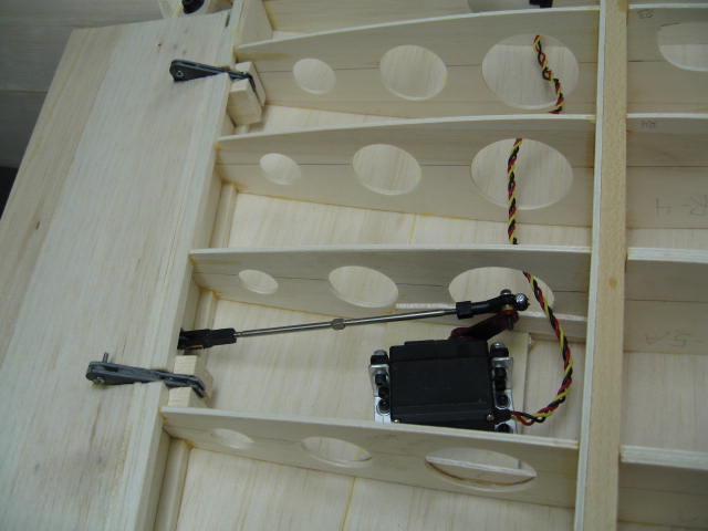

Here's a pic of how I did the flap hinges on my Bate's bearcat, they're pretty much scale.
The bearcat had freise ailerons and the pics that Chad linked to show a pretty good shot of how the hinge is below the aileron surface. Bates doesn't show the scale aileron hinges on his plans, they're a sport setup. I don't have any pics of mine yet, but I was going to make them freise type, but I didn't feel there was enough of a lever arm if you keep the pushrod inside the wing, so I just made a sport type with robart hingepoints buried about a half inch into the leading edge.

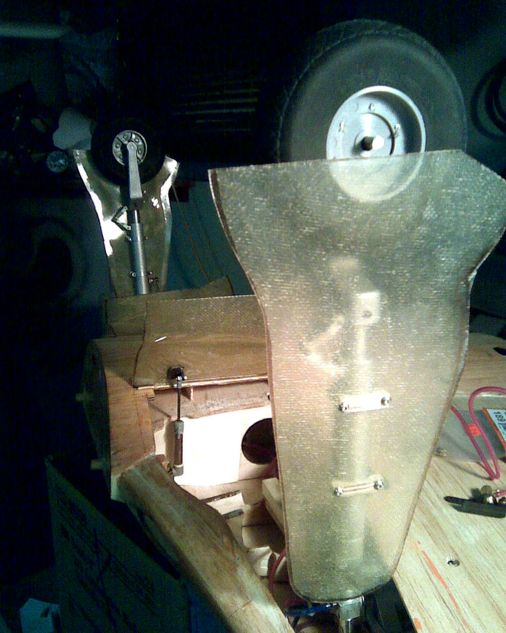

looking good !!!! you should be glassing this cat next week .. Lots of gear trouble with sequece valve and air bleeding onmy end ! If I can finish gear I can prime RareBear
