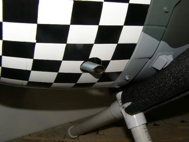

I'm running a YS-91 in my TF P-47 ARF. I just did a straight pipe. I had a 90 degree header from Central Hobbies on hand so I took the flare nut off of that, discarded the pipe, lightly flared a piece of 3/8" steel tubing and installed it on the engine using the flare nut. I angle cut the pipe it so it just sticks out of the cowl. There is a small hole in the side of the cowl but nothing drastic.
You could also bend 3/8" steel tubing into just about any shape of pipe you want to exit just about anywhere.

ChuckW- How does that thing sound with no muffler? I was thinking of doing that and since I fly in the middle of no where loud is OK.
Old 11-04-2009 | 11:30 AM
ChuckW's Avatar
Joined: Jun 2006
Posts: 5,165
From: Clovis, CA
Default RE: ys 91 exhaust angled stack
It sounds great. Kind of pops at idle like a little Harley Davidson engine or something. Full throttle sounds great too. It isn't that much louder than with the muffler to be honest. Maybe a little more raspy but not extremely loud.
