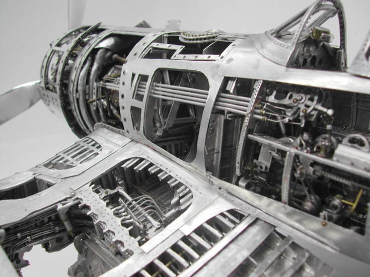

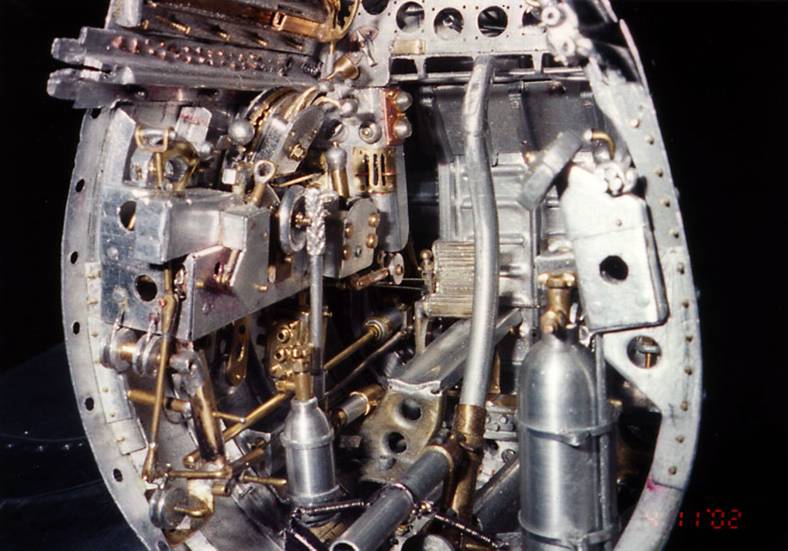

Remember this as you look at the pics........... All the controls work as designed, by cables, chains, linkages and levers.
All these controls WORK!!!!!........ And that means they work the parts of the aircraft via rods and chains as in the original aircraft!!!!
Every single part hand made and fitted.

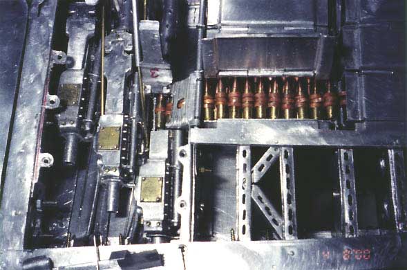

Machine guns and bullets.........
Detail of three .50 Cal. machine guns and ammo cans. Ammo cans are loaded outside the aircraft and then simply set into place in the wing. Their doors become the top surface of the wing. This allowed for rapid reloading by the ground crew.

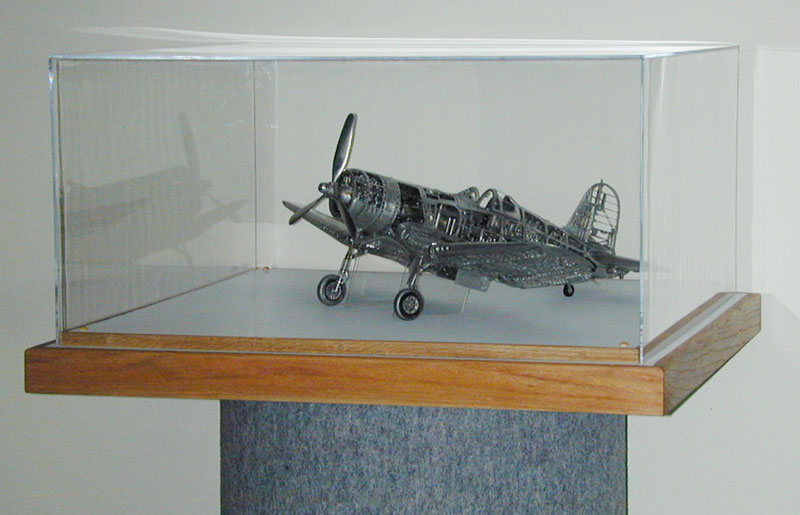

Mr. Park generously donated the first (cutaway) Corsair model to the Joe Martin Foundation. It can be seen in person in its display at the Foundation's museum in the Sherline building in Vista, California. A collection of photos showing how the model was built and all the historical data on the Corsair Mr. Park collected to build it has also been donated and is available for viewing. In 2005, Mr. Park also donated the second corsair and it is also now on display in the Foundation's museum.

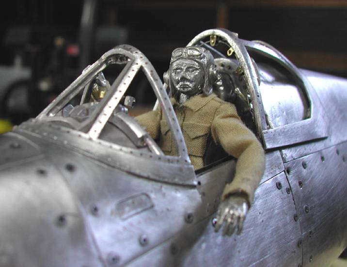

Showing the extent of his carving skills, Mr. Park sculpted a pilot's head and hands out of solid aluminum. The articulated figure is dressed in a custom made uniform and can be placed in any position to give a good sense of scale to the model.

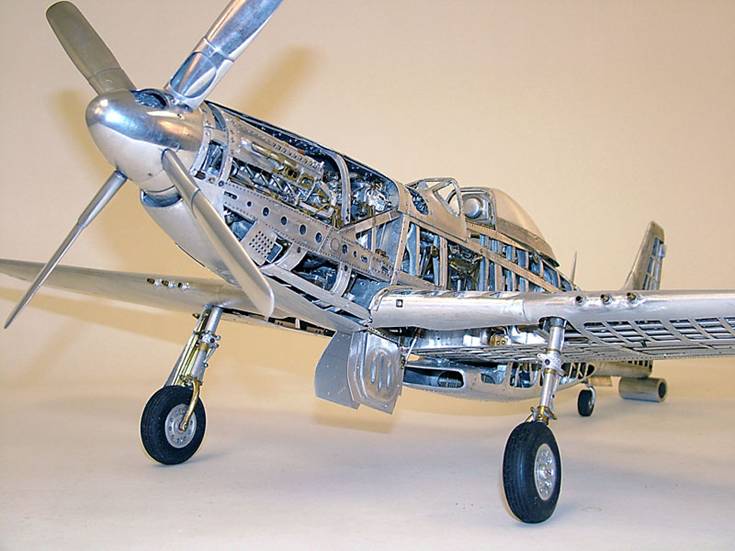

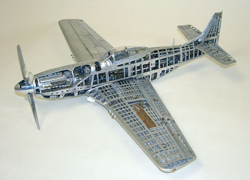

P51 MUSTANG

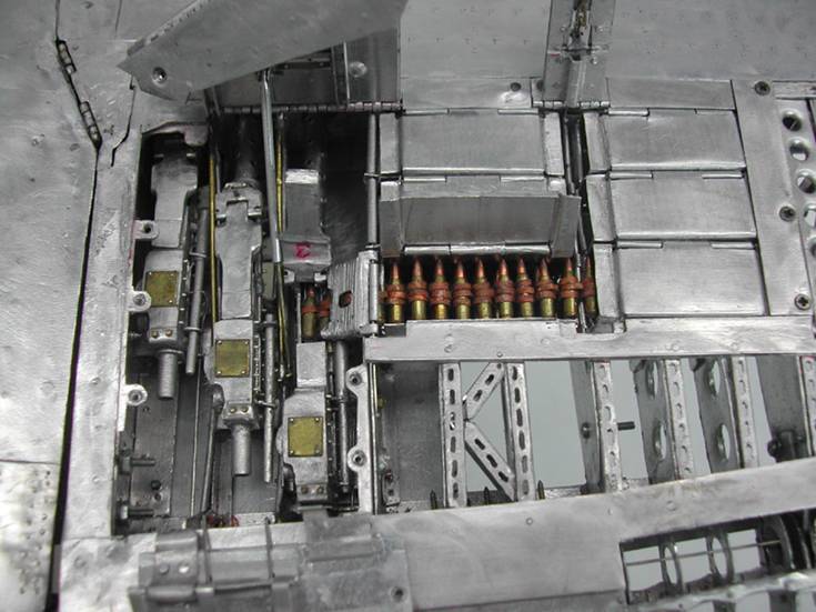

Inside the left wing you can see the 50 cal ammunition threaded into the three wing guns. Each round is machined in 3 parts—brass cartridge with copper bullet and primer and is held together with a small copper feed jacket.

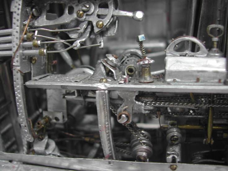

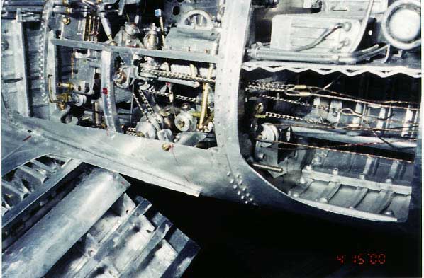

Control wires are being threaded around their pulleys underneath the cockpit during construction. (Y. Park photo)

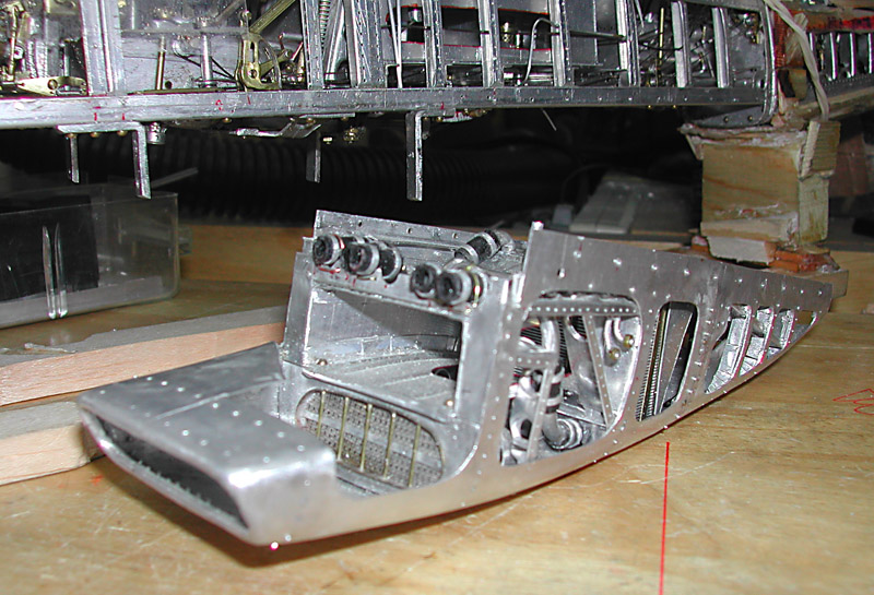

The radiator air intake sits under the fuselage ready for installation. Much of the detail of some of the parts is hidden once it is assembled. (Y. Park photo)

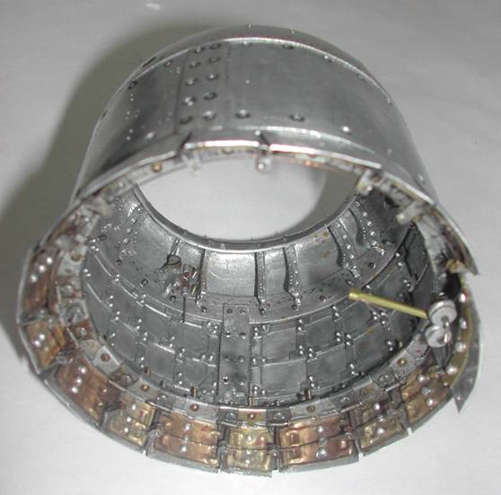

The form for the air intake and the final part. As is often the case in machining and model making, fixtures, moulds, formers and jigs to make the final parts can take a long time to make and are never seen by the public viewing the finished model. (Y. Park photo)
