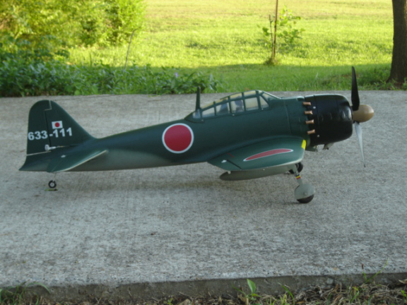

I replaced the SuperTigre .45 I ran in this plane last year with an RCV 60SP. The RCV is turning a Graupner G-Sonic 16x12 bobbed to 14" diameter. Turning this prop at around 5100rpm, she flies nicely with lots of torque. Not as fast as the little SuperTigre turning over twice the rpm, but the torque of this engine lets me power through pretty large loops with ease. I'm a big fan of that 4-stroke rumble and big prop too! Once you get these little Zekes properly balanced, they're a lot of fun to fly!

My finished weight is 7lb-6oz. It was at 7lb-2oz until I made that spinner for it. It is wood with an aluminum backplate. I just couldn't find one that was shaped correctly.
