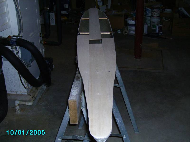

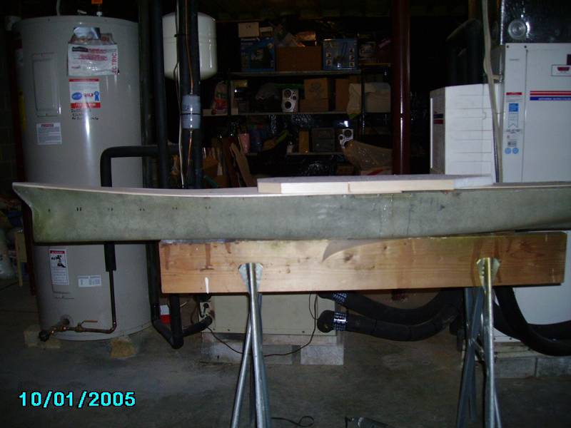

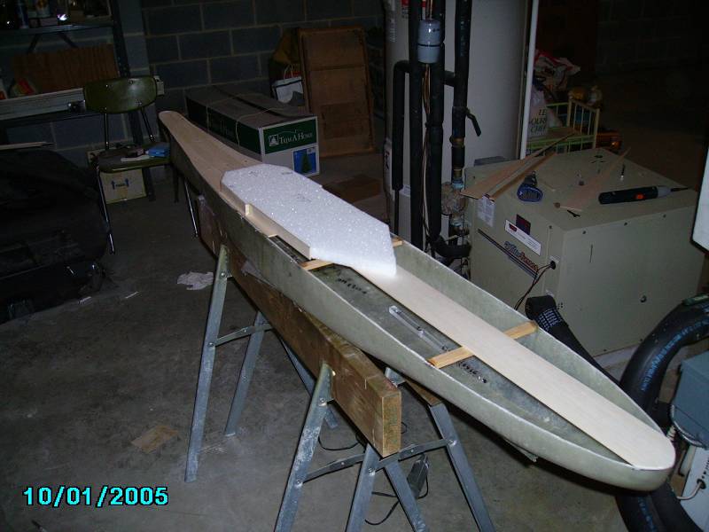

First set. Hull arrived on thursday, was trimmed and rejoined friday and saturday, started on the stringgers and top deck sunday, 'finished' top deck this morning. The white foam block is actually the L1 superstructure that is not complete yet. It is only 1/3 skinned in balsa.

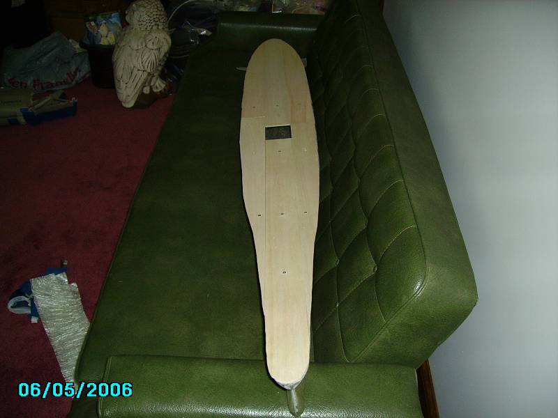

Last, on my ugly green couch from college! AND I finally figured out how to set the date on my camera!

Yes, the inner skegs are moulded in, Im still not sure if I am going to run all 4 props or just 2 for simplicitys sake and to be a little easier to keep with in speed requirements. (since rules say that not all props have to be installed, and not all props have to work)
I put the deck on so that I could send it out for a splash test to see how water tight it is, and what its nautral ballance is before adding any of the equiptment.
I liked Umi's idea of having it sink and but leave a section boyant so that the boat never really hits the bottom and never gets lost. So I was going to try and make the stern boyant so that when ever it sinks it does a BOW DOWN and then hangs by the stern at the surface.
