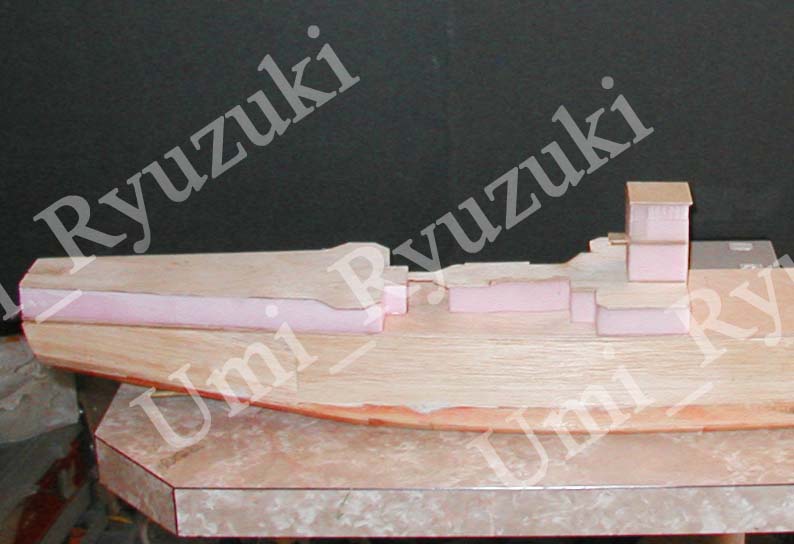

Stacked plywood gets heavy, and your ship will wobble and rock a lot if you pile all that weight up top.
Make floor and ceiling plates from thin plywood, 1/16" or 1/32" thick, and then sandwich a layer of pink insulation foam between. Just epoxy the three pieces together.
Then add balsa, or plywood pieces all the way around. I find that an light weight and easy option to create supersturcture.
