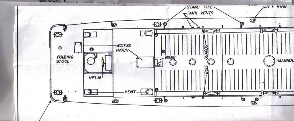

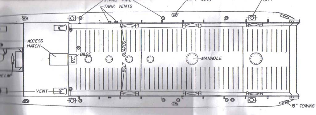

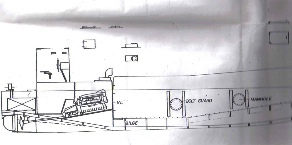

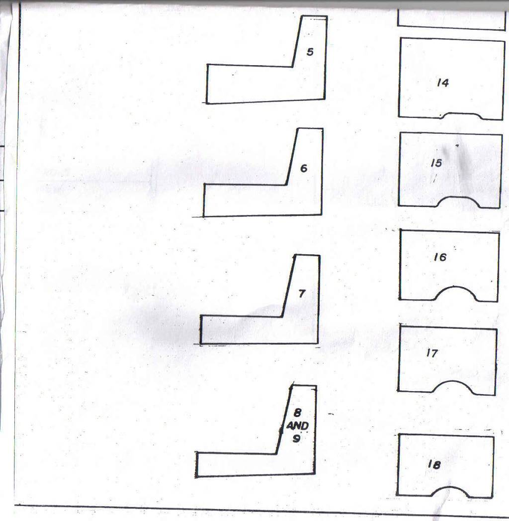

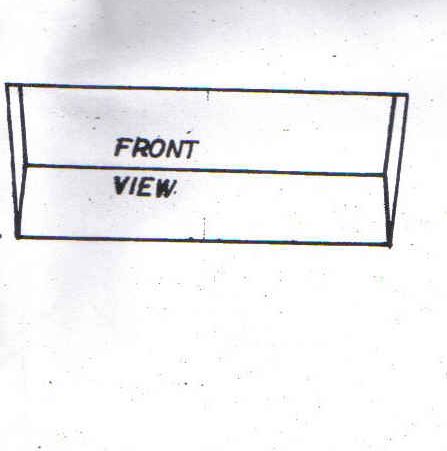

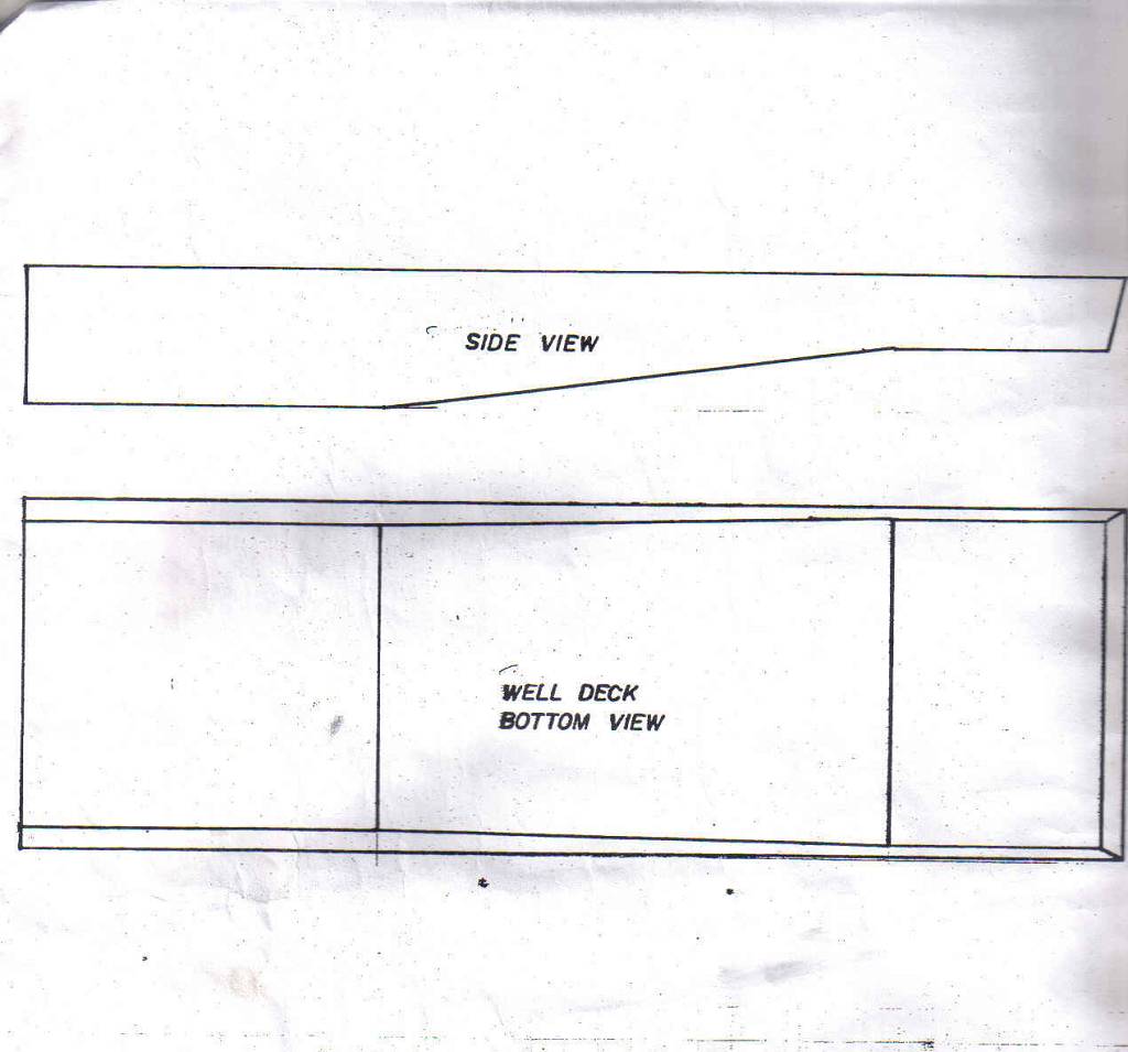

Do you have the plan's? Of one I forget who has a set that they will make you a copy of them and send it to you. I think i have a set somewhere. If i find them i post them for you.
Old 08-08-2010 | 11:22 PM
Deathwish's Avatar
Joined: Jul 2005
Posts: 1,030
From: White hall, IL
Default RE: How to get started?
Here you go. I have one more pic to upload yet.
