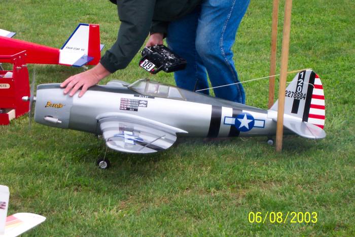

Otto, I have the ModelTech P-47 Thunderbolt and am interested in the RCV engines. The information for the plane is as such:
Rec sizes for reg. engines: .61-.91 2c or .80-1.00 4-c
(most people go with a 1.00)
67" WS
wing area:785 sq. in
weight with engine: 10-12lbs
Against many of your postings i want to run the scale 4-blade prop. I have the ability to get a Zinger wood in just about any size.
With all that said which RCV do you think 60-90-120? and where would you start in the prop sizes, as i know it'll take lots of testing with various. The 120 will fit easy and the cooling is not an issue- I have functional cowl flaps.
~Ray
attached is the a/c with a person for reference...

Dear Ray
Thanks for your interest in using an RCV SP series engines.
Based on your specifications the RCV90SP would be perfect for your plane.
With regard to 4-bladed propellers, we have not trialled any Zinger 4-bladed props, however we know that an APC 15.5x12 4-bladed prop works well with the RCV90SP. Wooden props are generally less efficient than glass composite propellers but we would certainly like to here how you get on.
