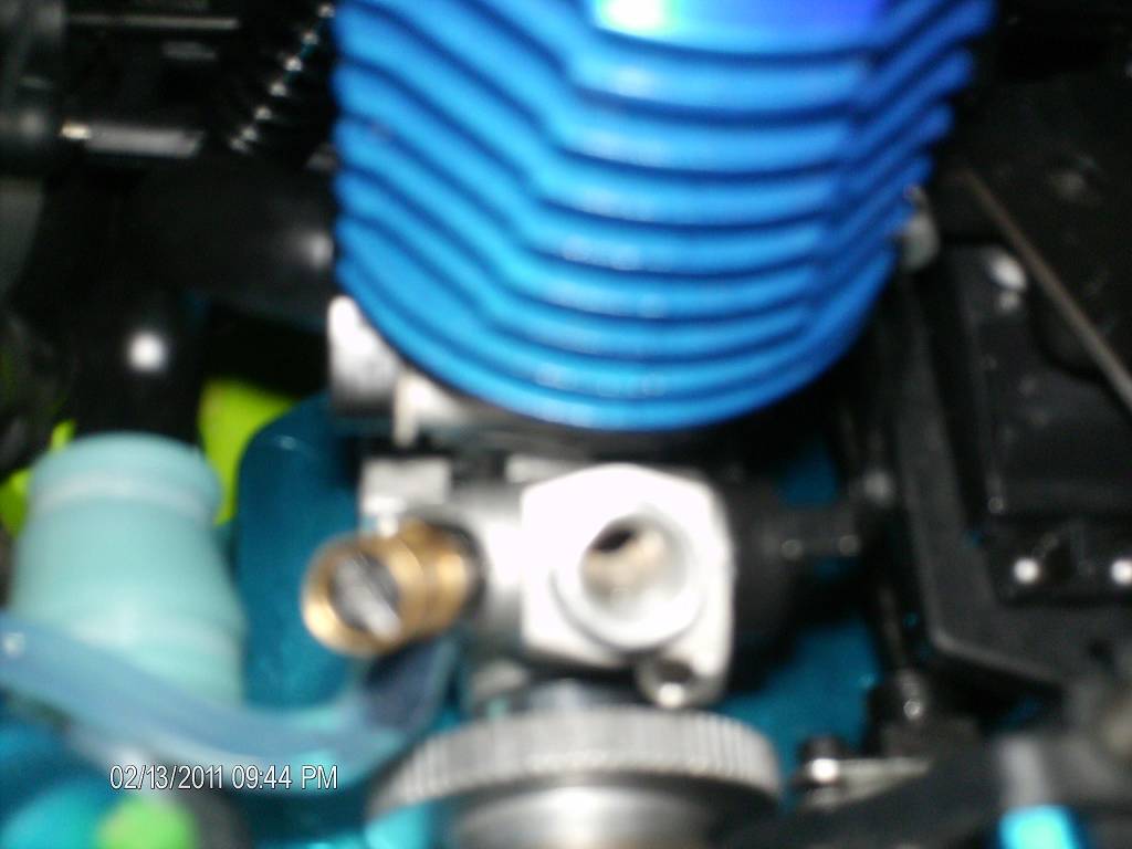

hey nitro how do i upload an pic on here i tried once but it wouldn;t let me, i want to take an pic of the carb gap and show it to u.

ORIGINAL: thunder5005
dont give up just yet. i mean, i know the volcano has been a headache for you, but the t-maxx should still be worth alittle work!
when you make a post, look below the area you type in.
see the "click here to upload images and files" click that and a window will open which will let you browse your computer and find the image you want.
you got the t-maxx new right? did you get it on ebay, or at a hobby shop?
if from a hobby shop, i would see if they will fix the starter motor for you.
was the motor turning when the starter motor smoked? if the motor got flooded, then its too much work for the starter motor and may have caused it to over-heat. but you would have had to be using the electric starter ALOT for that to happen.
a replacement motor shouldnt cost too much. i dont know if traxxas may also replace it for you???
on the volcano, if the idle screw(which adjusts the gap in the intake) wont move the gap, it may be because the carb's slider has rotated into the wrong position.
try rotating the throttle linkage on the carb while trying to screw the idle screw in. the carb's slider has a spot for the idle screw to rest, and the slider may just need to be rotated till you find that spot.
if all else fails, you could post the trucks in RCU's marketplace. if you sell them both, you should make enough to try out a brushless electric truck. far less can go wrong with electrics!

heres a pic of the carb gap

I had the same issue with the idle screw on my s30. Nitro is right that the throttle has a place for it to seat. You may need to rotate/ or push in on the throttle barrel for it to start threading back in.
yeh thats a little bit too big of a gap IMO.
find the seat for the idle screw on the slide as was mentioned.
