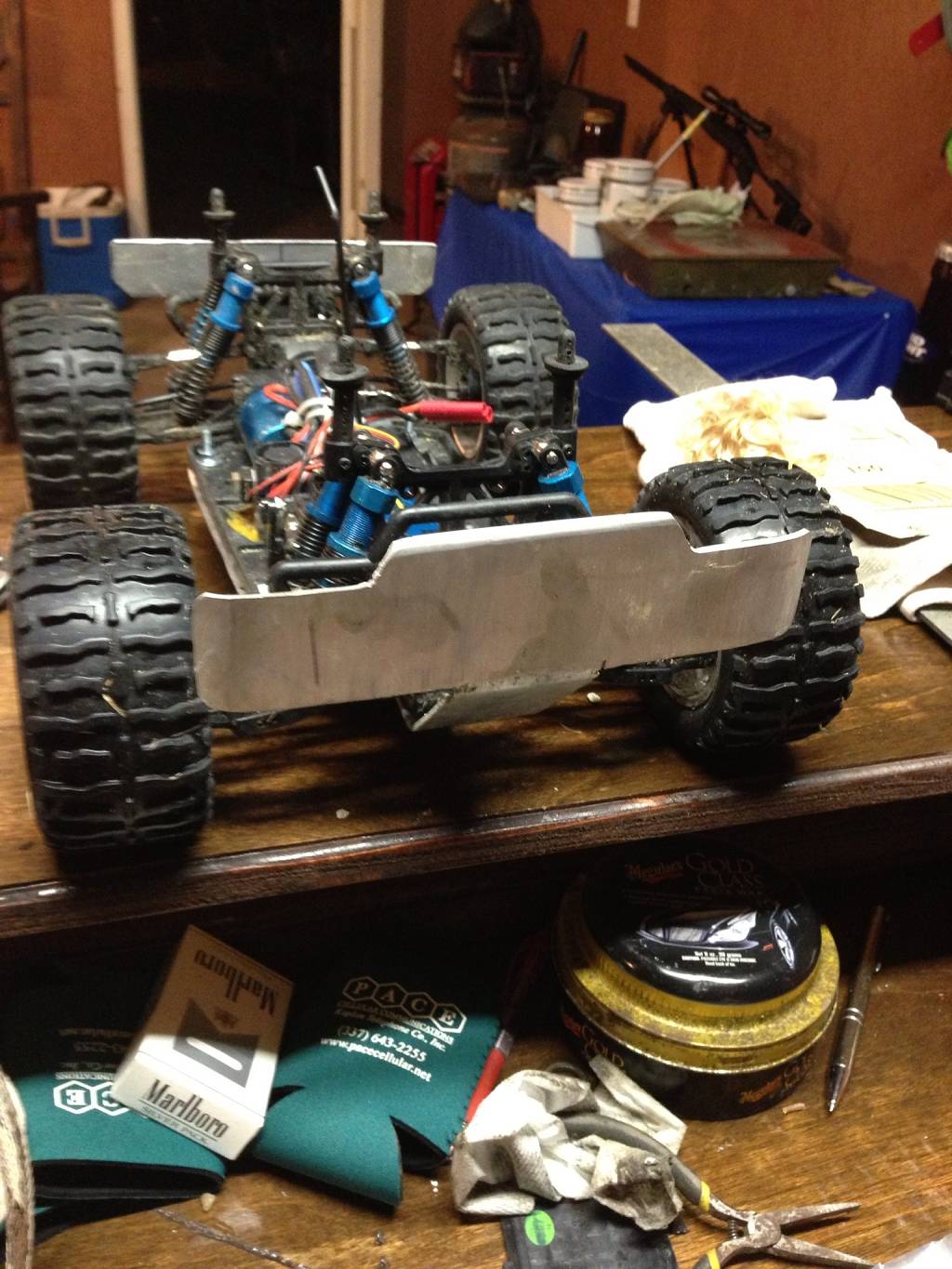

We all have the epx pro models and have been building many Aluminum upgrades. If you can't force the chassis to accept nitro version it is possible to upgrade to aluminum with a little home engineering. See below. This bumper took a direct pole hit at an easy 40 mph lipo epx. Still in tact.

ORIGINAL: Johnathond22
jeez, nice work man!
You just traced out the chassis, to cut the alloy one. Now you have heavy duty bumper as well as skid plates.
I also like where you bolted it to the chassis. You picked points that dont get any stress. If you had bolted it with the screws that hold the stock chassis to the diff cases that could have caused an issue.
Only thing I would have done different, is I would have used a much larger drill bit to make a countersink hole. Then used flat head screws to get them flush mounted with the alloy chassis.
You know, multiple people lately have been asking about alloy chassis for the volcano. Perhaps you should consider making/selling what you have there!

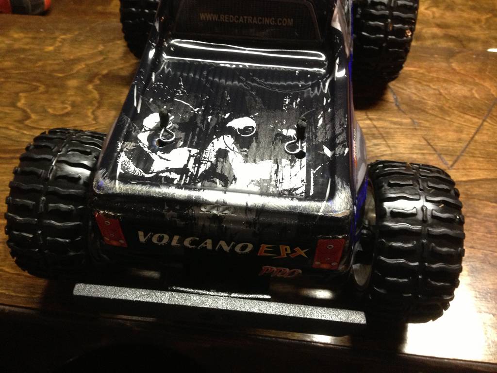

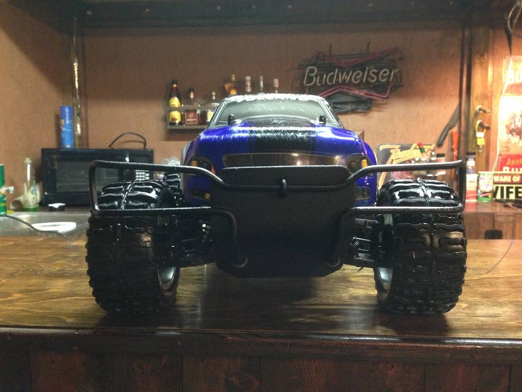

Ok guys, I am now finished the final run of the Full Gaurd. Have a look. Let me know any thoughts or ideas.
Details are that the chassis skid and core is made of 1/8 aluminum and the rear bumper is aluminum 5/16 thick plate for realism. The front Gaurd is 3/16 stainless rod. That was most likely the bulk of the work to shape a full realistic look. All is now Rhino lined and mounted ready for the bash!

Is that a axial or emaxx bumper on the back?
Old 12-29-2012 | 11:01 AM
Joined: Dec 2012
Posts: 54
From: Kaplan, LA
Default RE: chasis compatibility??
It is a "Shear Hobbyz" rear bumper as I made this too and we are calling my "Hobby Shop" Shear Hobbyz" we we refer to the RC fun. It's not really public as I am not sure if I am ready to help the public. It's al l still just for fun right now. I am considering becoming a red cat dealer though.

Iwould definitely want it black. The back bumper is fine how it is. Iwould maybe shorten the base of the front one a litlle, as well as the bars. Maybe to half of the fronttires. It be nice to protect the new body i got, cuz those stock bumpers are useless for that.

Ok, I need a measurement from the wood to about 1/2 inch under the lights, we don't want to block the lights. I'll make an eighteen wheeler style push bumper.
