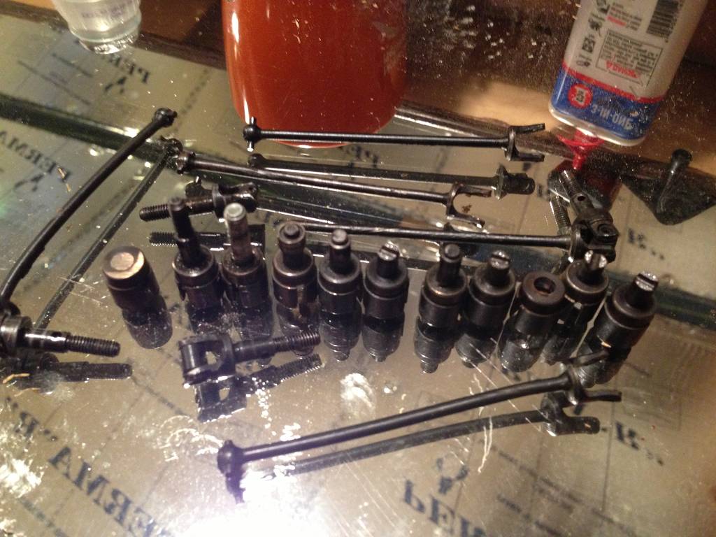

Hey guys,
This quick pic is just to clarify that I wasn't exaggurating when I had said I pass through stub axles at an alarming rate. This is just the ones I still have. I have most likley thrown away more than this. Just clarifying why I had tried so hard to find a stronger solution. To be honest, I know why they break, we typically bash hard and make ramps that should require a pilots license. However, I felt like if the stampede could do it, I was gonna do it too.

man, it really sucks you broke the stubs even on the CVD driveshafts, those aint cheap.
I personally think its best to stick with the dogbones.
