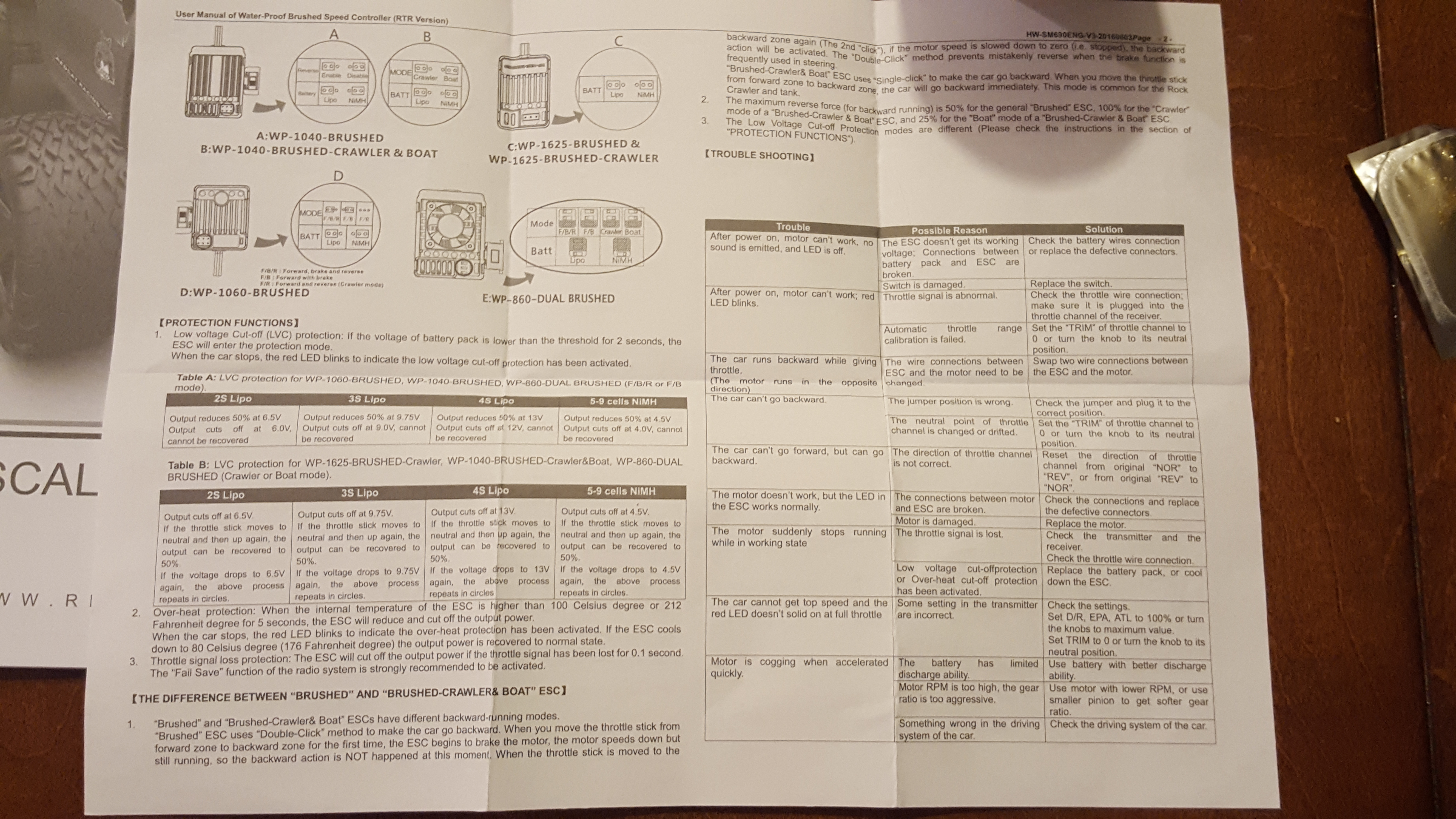

How do I enable the Low Voltage Cutoff on a brushed blackout xte? So that i can run lipo. I've searched and read the manual but all I can find is how to for the brushless model!

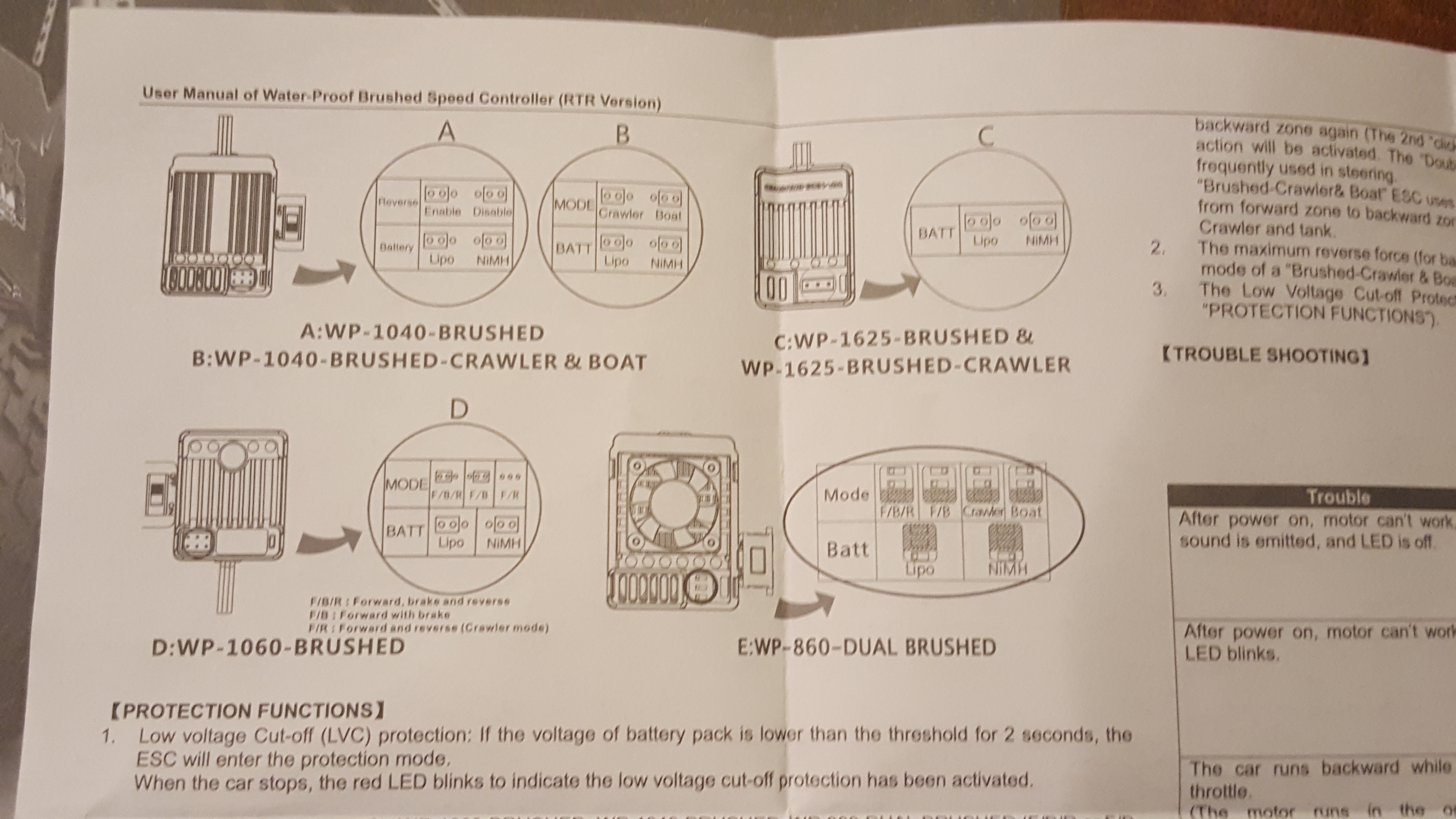

The esc they use is a cheap copy of another cheap chicom esc. It uses jumpers to set reverse and battery type. The jumpers are located on the rear corner near the wires that connect to the motor. The battery type jumper is the one near the outside edge of the case .
Move that jumper from the rightmost and center pins over to the leftmost and center pins to set the lvc for LiPo. Refer to the attached pdf.
You won't find that anywhere in the manual or on their site.
Good luck with that truck !

Thank you, I would have never found that but I see it now

I put a 2s lipo in mine and love it. This sheet was right in with my manual of both of the cars I bought on Christmas Day. Once again flyinwalenda shows up to bash redcat. If you're going to bash a company at least be accurate about it when you say you won't find something in their manual or on their site. For somebody who absolutely hates their products you spend a hell of a lot of time browsing through their forum. I would love to know the whole story behind where your personal vendetta comes from! Must be a good one.

Thank you, neither of the 2 blackouts I got came with that sheet
