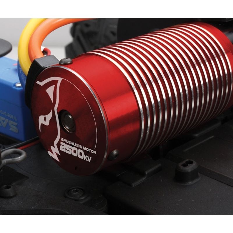

Those housings are to keep leaves and mud away from the fan. It could be left off. If you do end up with a wp--100/120 go to a redcat 42mm 2500kv [191007r] motor. you will like it.

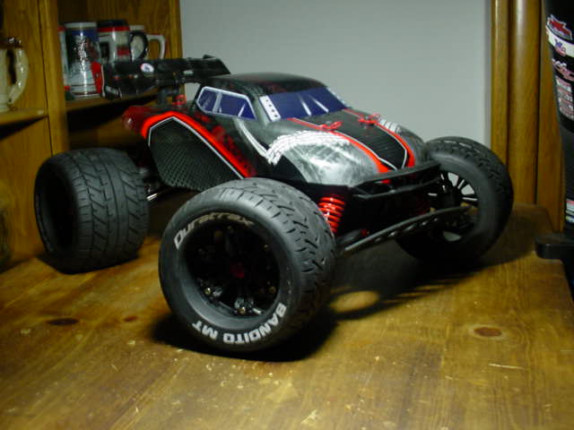

I have a set of these with a street tred. They do not balloon because they are belted However they are not real tall [5.5] Link:
Belted Monster Truck tire Terrain Crusher by Sweep Racing for TRAXXAS E-REVO

Default 2500kv
redcat 191007r 2500kv, maybe. the motor leads come out the side. Your original leads come out the back. There are many others for a variety of prices. I may have one but investigate first.
