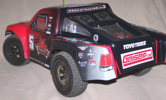

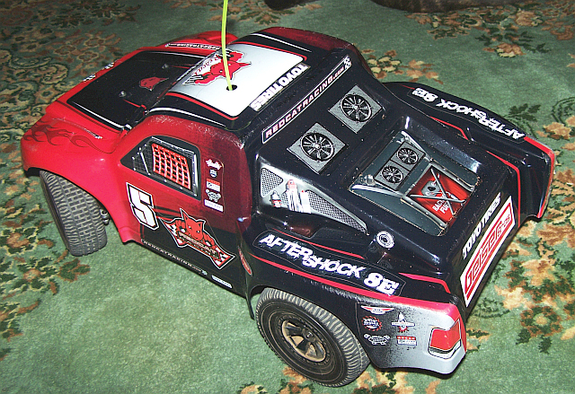

I just thought you might want to see some pix of my Aftershock Truck

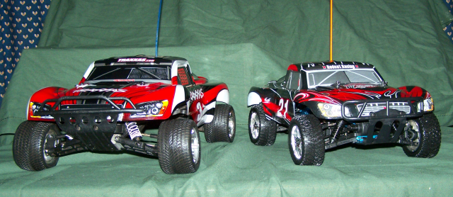

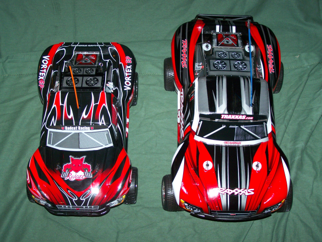

I own some Traxxas Slashes also and just thought you would like to see it side by side with my Redcat Vortex. (they both are 1/10th scale)
