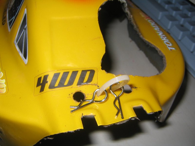

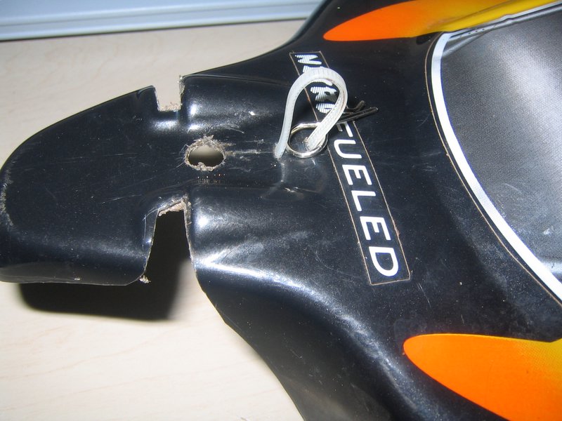

Yeah I kept losing all my body clips so I ended up cutting a couple slits into my body and sticking a ziptie into it. Now all my body clip are secured to my car always.
