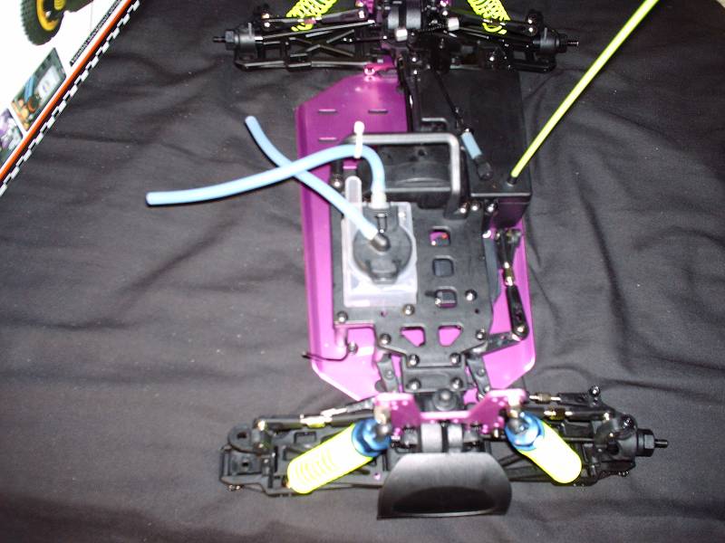

tornado xp...220$ nitro,glowplug igniter,glowplug...39$ starting your car for the first time and having it go crazy on you and hit a wall at full throttle breaking your rod and putting shrapnel in your brand new engine...priceless

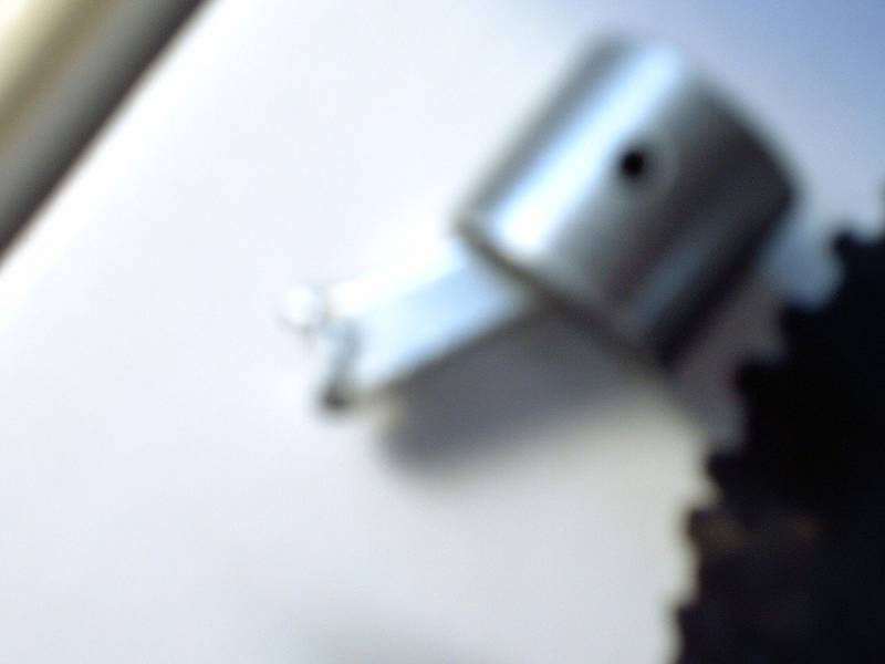

anyway thats what happened to me, An rc car horror story. When i go to start my brand ass new tornado xp the throttle was all the way open. so immediately my car takes off as fast as it can go and races around for 15-20 seconds until its stopped by a brick wall and i am able to grab it. i go to start it up again and break in whats left of by motor when my pull start wont pull. so i end up breaking that too in the process. i later take my broken wreckage of an rc car to the local hobby shop(hoppy people)to find out the extent of the damage and to get a new pull start and front hub carrier.i find out that my sleeve was too big for the piston and the rod snapped of the crank shaft.I'm hopeing to find a replacement piston rod and sleeve so i don't have to buy a new motor because the block is in good condition. if anybody can help me let me know.its a tornado xp .18 motor, all i need is a piston rod and sleeve, if anybody knows where to get these items or has any extras please contact me.thanks
topspeedtoys.com has engine parts, you have to always make sure there are batteries in the car and tranmitter, that they are on and everything works, and make sure the idle it set correctly, about a 1mm opening in the carb, (gap seen when air filter is off). sorry to hear it bro.

Hey man welcome to the forums, sucks that it had to be under these circumastance though. Do you know why it took off on ya like that? Did you have your radio and reciever turned on and working? Just instinctively before I go to start my car I'll pull on the throttle trigger and turn the wheels to make sure things are working right. You should try and make that a habit. Topspeed has all of the engine parts that you'll need and he's a really reliable guy. You won't go wrong dealing with him. Hopefully you'll get the parts that you need and you'll be up and running real soon.
And just as a little tip, be sure to thread lock the screws on your back plate when you're putting everything back together. They tend to wiggle out real easily. And while you're at it you should probably go through and thread lock as many screws as you can. Especially the metal to metal ones. It'll save you a ton of trouble later on.

Welcome to the forum bud !! Yeh , that really sucks !!! Mine had a bad throttle servo when I got it and a bad transmitter. Make sure if one of those items is the trouble to get it warrantied fast. Only thirty day warranty on the electrical.
