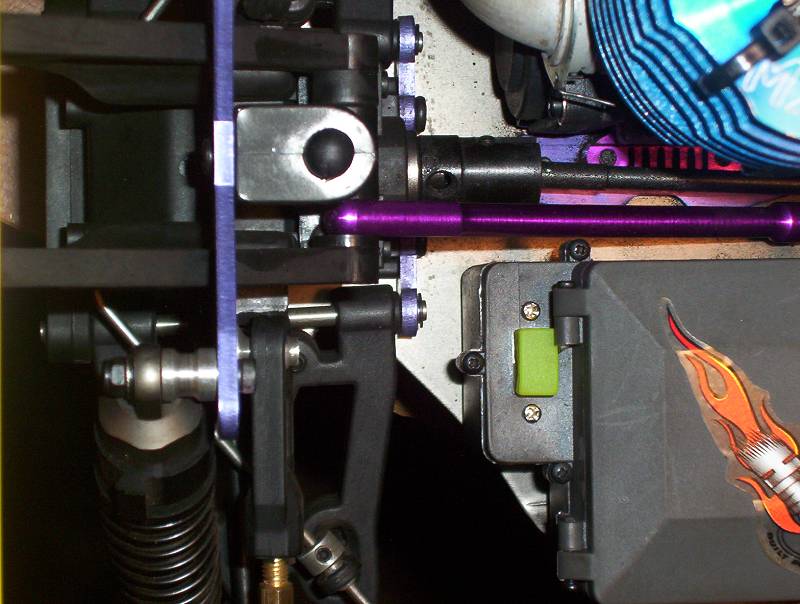

Hey there can some body give me A hand does the rear and front diff drive cups have set screws in them? it looks like the one in the rear fell out. When you spin the front wheels and hold the rear one's they do not move at all any help please???

yes m3 or m4 i dont remember right off hand use loctite they are known for coming loose

WELL MINE FELL OUT DO i HAVE TO BUY THE HOLE CUP TO GET THE SET SCREW? PART #81018 sorry about the caps I left them on

no you can get set screw part # 02098 m3 part # 02099 m4 like i said im not positive wha ones youll need but i think its m3
or you can go to hardware store and buy them alot cheaper remember m3 m4

One more thing it looks like the front one fell out to? but the front wheels turn fine is there only one in the rear?

no there a setscrew on every drive cup -12 total 2 on tranny- 3 on front diff 3 on rear diff- 4 on axles

Hey I found of all things two of the screws in my old airplane stuff!!! Okay now do I set the set screw on the part inside where it is flat or just screw it in any where?

yes where its flat use loctite or super glue though

Got it and I had three of them and I locktighted them in and I will use the last one to take to the hardware store tommrow. Thanks sooooooo much I just love this site people helping people it's great[sm=thumbs_up.gif] thank you very much giddyuperic now maybe my buggy will go two times fatser.
