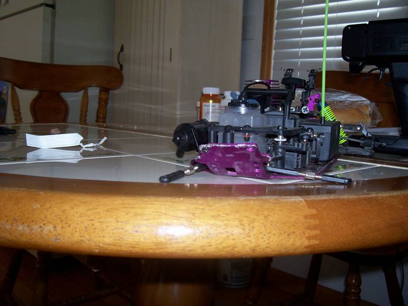

After I crashed my buggey into the crub I was checking what Parts i would need.I turned the remote and the car on but when i pulled the trigger nothing happened.I put new batteries in both and still nothing.Does anyone know what the probelm could be?

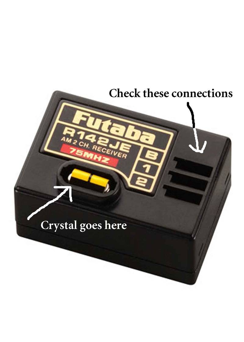

When you switch on the reciever do the servos 'Twitch' or turn on?
If they don't then just try checking all your connections into the reciever.
If they turn on, then make sure that the crystal in the reciever didn't get knocked out of place.

The crystal looks like a little metal car fuse. It plugs right into the reciever.
But since you're not even getting any power to the servos I would check all your wires from the battery to the switch and then to the reciever. Baisically you just need to narrow it down to the problem spot.

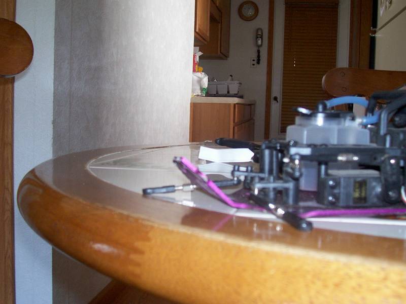

it was this hard of a hit

here a pic of crystal and connections to check also check battery holder battery may have popped loose

DUDE! I can't even believe how messed up that is. That chassis is bent at like a 45 degree angle! It's supposed to be FLAT! LOLx1000! You're gonna need a lot of muscle, a vise/sledgehammer and possibly some heat... At least you are putting smileys in your posts, so you can't be too upset about it. A new chassis costs like $25 bucks or something, if I'm not mistaken. At least that's what my buddy with a Hurricane XP said...
