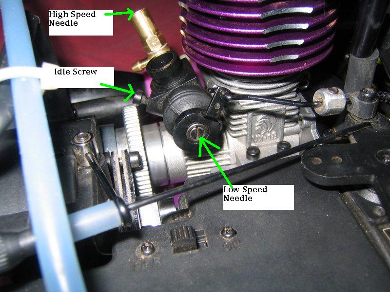

this came straight from the redcat faq thread so im not taking credit for this but it will help you
Probably one of the hardest things to do when you first get into this hobby is learning how to tune your engine. One of the problems I first had when I got into nitro was simply realizing what everything was and where the adjustment screws were. Well anyways, here's a picture of the adjustment screws.
The following are what the factory settings are incase you ended up tuning things to the point where the car won't start anymore:
High Speed Needle (HSN) - Turn the screw all the way down (clockwise) but don't tighten it. Then unscrew it 2 1/2 to 3 turns (Counter Clockwise).
Low Speed Needle (LSN) - Should be flush with the collar.
Idle Screw Adjustment - Take off your air filter and make sure your throttle is at idle. Then make sure that the opening in the carb is about 1mm.
Hope this helps. If anyone wants to add anything to this feel free to.

after break in you want to turn the highspeed needle about a quarter to half turn to give the motor a little more power, just remember clockwise= more power but higher temps, counter clockwise= less power but cooler runing, motors arnt ruind by runing them too rich, there ruind by runing them too lean, so the first thing u need to do is buy a new temp gun, a general rule of thumb is the motor should be runing under 300 degrees if its 300 or over the motor is too lead and needs to by richend up (by turing the screw counter clockwise), but remember when making adjustments to the carb always do it in quarter turns or less NEVER in full turns. and if u screw it up u can start over by screwing the needle in clockwise till it starts to tigten up, and then bring it back out about 2 and a half turns. go to www.towerhobbies.com did that make sense or just confuse u lol?

oh and for now only mess with the highspeed needle, dont mess with the other ones if your not really experienced in tuning u can really screw up the motor fast by doing that, iv been tuning for a long time and i still stay away from the other screws on the carb

Is the idle adjustment screw really supposed to do anything? I took off my air filter to make sure it was about 1mm.. but the screw doesnt do anything...any help? thanks!!!

you may have to adjust your throttle trim on the transmitter, even though the idle screw should still adjust the idle.

yeah i usualy never touch the other screws besides the high speed needle, and do all my tuning with it, not because i dont know how to adjust the others but just cuz its not nessisary, at least not for me. and i adjust the idle with the trim too.

Never adjust idle with your trim settings. Learn to use LSN, its the most critical setting.

if the engine is tuned just right, it should explode right off the line. When you go wide open throttle, it shouldn't even struggle, it should wind up and haul ass. If it bogs down, you are too rich on the low speed needle. Your high speed needle controls your high speed performance, and the amount of fuel goes to your low speed needle.
