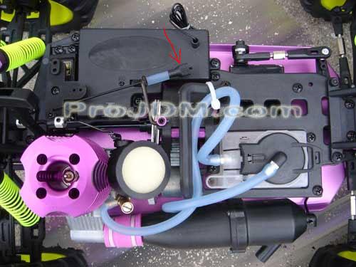

cool thanx for helping, theres a lot of stuff to learn in this hobby. i thought you just put gas and start i was wrong!also my brakes dont work very well.any suggestions on adjustments or upgrades?

Ok there are 2 ways you can do this. The first way is : There should be an adjustment that is connected to your break and your throttle arm. The picture with the red arrow pointing to it. The 2nd is your trim on your radio if your turn it clockwise is more break counter is more throttle.

also if you have took your throttle servo horn off you might have to reset it for the brakes to be engaged

i had to change my throttle servo because it wasnt strong enough to break or something, put a futaba servo in and it was fine.

do you think he should check the allen screws that hold the break shoes togther? I did have mine come alittle loose.

they are supposed to be a little loose, too tight and they will create drag.

they shouldnt need to be tightened up that quick didnt he just get his car but you never know maybe they were to tight from the factory and it wore the pads so you might want to check the brake pads and make sure they arent to loose

THANX FOR THE HELP I WAS MESSING AROUND ,THE THUMB SCREW WAS LOOSE,ALLENS ON PADS WERE LOOSE,TRIM WASNT SET IN NEURTAL. I ADJUSTED IT AND NOW ITS RUNNING/STOPPING GOOD.IT HAS ALSO FLIPED PRETTY GOOD PRETY HARD TO CONTROL AT FIRST BUT IM GETTING THE HANG OF IT

just make sure you didnt overtighten the brake pads or you will wear the pads down very quick and there might be more stress on the motor if there real tight
