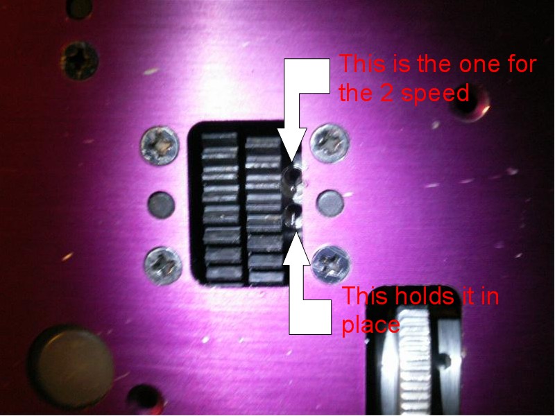

My son has a tornado he got it at the begining of dec. we have had a few issues but nothing major untill now,it seems that it is stuck in 2nd gear. Is there any adjustment? I have a savage x with a 3 speed so I anderstand adjusting. please help thanks!!!

Yup you need a new one of these, sounds like your grub screw in your 2 way drive clutch come out, plus I would buy some BLUE lock tight and go through the whole buggy and take all metal to mtetal screws/grub screws out and put some on them all or you will have a lot of things coming off.

or look at the 2 way drive clutch and see if it just come loose and screw it in more

do you have to pull it apart or is there a hole to make an adjustment??

There's a hole on the bottom let me get a picture to show you

Here it is, the tighter you screw it in the longer it takes to switch into 2nd gear
