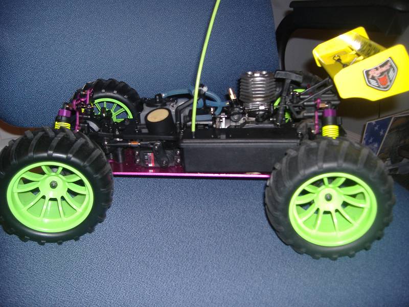

i got the cheapest 1/10th redcatracing Shockwave with the .16 i'v been runnning it alot i bought bigger tires for it from the redcat Avalanche but the engine overheats i'm going to buy the .18 for more power besides the engine what do i need to get for the upgrade? and how much work will it take

Low tooth CB

Change the gearing.

how are you going or did you fit those tires on the shockwave, one is 12mm hex and one is 17mm hex.

the tires fit perfectly i was also amazed

take a picture, i would like to see that

sorry i think the tires are from the volcano

good but those are volcano rims and tires, not avalanche. looks cool though, use a 13 tooth clutch bell for those tires, you will have no low end power with the stock clutch bell.

the tires are going in the wrong direction and dont be sorry, it looks good.

i thought the tires were backwards

no, it would be worse with the 2 speed. the .18 would help you out a little, trade the .16 in for a .18 sh, it will cost like $50 with the engine replacement program

2 Speed will lower the low end. Yeah, if those were avalanche tires, the WheelBase would be like 2 inches, LOL
