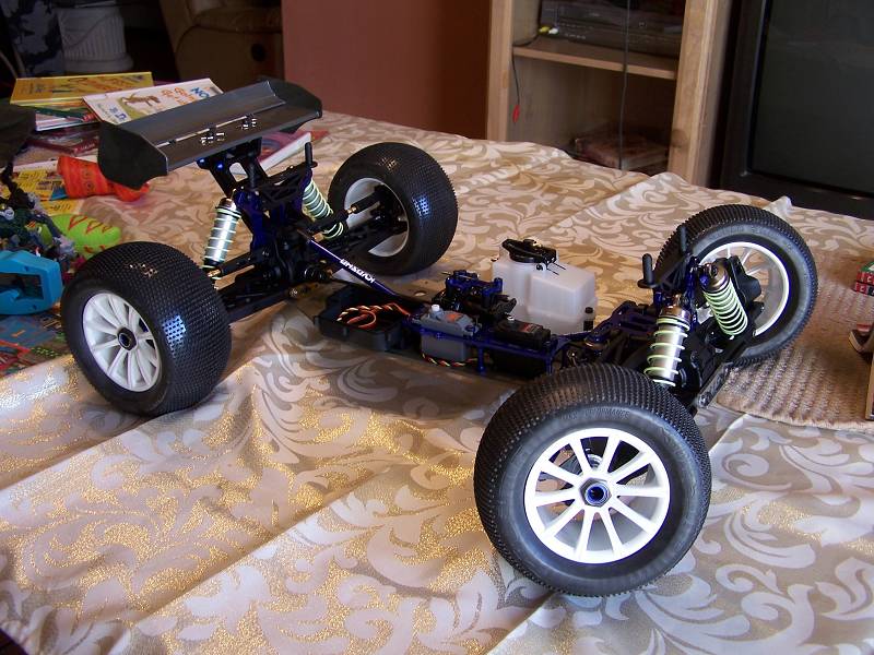

Default RE: wheel dye
My wheels were yellow and the dye trick worked awesome.
I used the same liquid RIT Dye but used up the entire bottle. Ouch!@ $22 a bottle, but it worked and its black. The dye will be put into a 2litre milk container so it can still be used in the future.
Also found that the water needed to be quite hot, not boiling but kind of near it. Probably around 70°-80°. I had the barbecue on low the whole time and stirred every 4-5 minutes. Found that the dye wont penetrate the nylon anywhere where there are traces of CA (Superglue) left from gluing on the tires. Another reason why its best to dye while the rims are bare. Any spots I found like that I just rubbed over with acetone on a cotton bud until the dye penetrated.
I found the rims needed at least a good 15 minutes to get a nice black. The wing was a different story. I had to transfer the dye to a bigger baking dish and do the top, bottom and sides in three goes. Still worked and the finish looks even.
I haven't noticed any issues with the tyres yet from being soaked in the warm water, but I am yet to run it. Hopefully get it running tomorrow but dont envisage any problems.

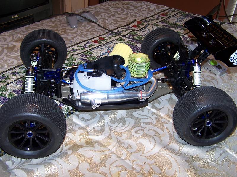

Here is what my fried wrote me to dye my stuff and have used it many times already and works perfect. This is using RIT dye from the grocery store laundry section for about 3-4 bucks
heres what i did. step 1. bring more than enough water to completely cover your parts (keeping in mind some water will evaporate as you boil) to a boil. 2. pour in your dye and stir (more for a deeper color or less dye if you want a lighter shade of that color, that wing was dyed at full strength for 20 mins) drop your parts in what ever container you have that you dont care about. *note* container will probably stain with the dye!! I bought a tupperware bread container because its deep enough for 4 rims or to fit that wing in, it looks like a loaf of bread. it cost $5.00 at walmart. 3. Let them sit, stirring occasionally, for about 20 mins. this way you dont have any white spots from them sitting on the bottom of your container. ( less time if you want a lighter color or more time for a truer, deeper color.) you can check them at anytime and when it reaches the color you want pull em out. I used a zip-tie through the mounting hole to pull it out of the dye to check for color. 4. let them cool then rinse with clean water. done. most importantly................................
Whatever you drop the dye on you need to clean it up IMMEDIATELY because it will stain. tile floors, counter tops, kitchen towels, your clothes even your hands will have a tint of the color. dont get thrown in the dog house by your wife because her tile floor is blue!!
Here is a before and after I did.
ID:	889928   Click image for larger version
