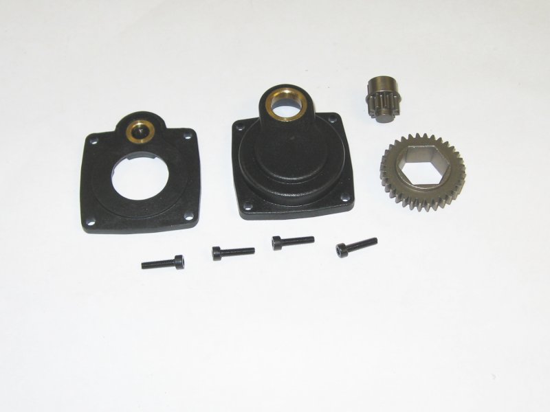

i have a RedCat TSUNAMI and what roto startthing would i need im very new to this and what back thing on the motor do i need and a gun to turn it i have a drill but don't know if it will work
why im asking is the pull start on mine don't seem to catch something and when i pull it nothing turns just the string come out will i have to get something in there to befor i get the roto thing or if i get that back plate and that will it fix the hole thing and i will not have to pull it lol

THIS IS WHAT YOU NEED.[img][/img]

Your one way bearing may be bad.
If it is, a roto starter will not help. You need to clean or replace the Bearing.
Your one way bearing is dirty and it will do the same thing with an electric start system so get used to it or make sure you purge all the fuel out of the engine every time you shut it off [&o]

i don't think we talking abut the same thing but i could be rong when u pull the string it just comes out it dose not turn the motor over at all its like a yoyo or something
and if i do need something could u give me a link or a redcat part numer i don't even know what the one way bareing is sorry

Its the same thing M8, pull off the pull start and clean the OWB is all you need to do

it worked lol i don't know if i want the roto start thing now lol its to easy to pull i can spend the 25$ on something else for it
