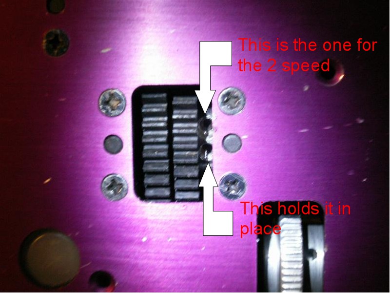

i have a 1/10 scale redcat truggy and i need more take off help

Default RE: more take off
it is slow on take off like it is stuck in second gear

assuming that it is a 2 speed, it is very possible that it is stuck in second gear.. seen it happen.

ORIGINAL: peewee146
look under the truggy here is a picture of where the 2 speed clutch adjustment is, do not touch the one that says this hold it in place, thats what holds it on the shaft, now see if you can see the grub screw in the hole that says this is for the 2 speed, if you can see the grub screw in there turn it to the right/ clock wise, and that should make it shift later, if you dont see the grub screw in there then it has come out and you need to get a new clutch drive. and if it is in there and its tightened all the way then the ball thats in there is stuck some way and you can do one of 2 things take it apart and put it back together after you unstick it or buy another drive clutch.

hey i tried that it did not work it runs fine at high speed just on the take off it a slug

so if i want to shift quicker i turn the 2-speed screw counter clockwise?
Old 05-23-2008 | 12:32 PM
Joined: Jun 2005
Posts: 2,824
From: Clermont, FL
yes. That will loosen the spring pressure and it will grab sooner.
