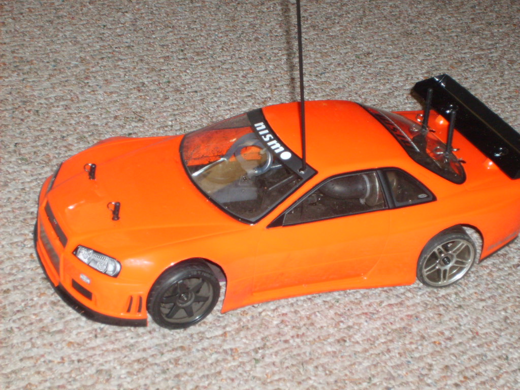

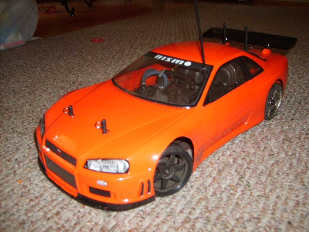

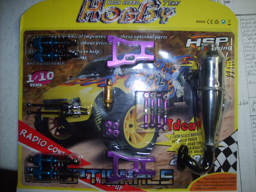

hop up kit, change the clutch bell to hpi with the hpi gears email all about fun hobbie for them, and u could put a sh.18 motor on it!!
here couple of pics of mine
