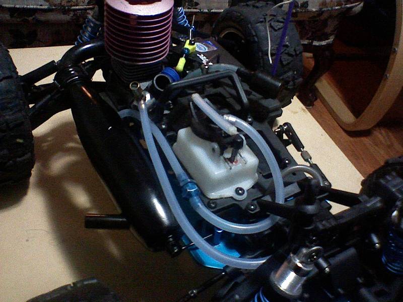

Hey fellow Redcat drivers. I'm sort of stuck in a small issue regarding my Volcano and her fuel issues. After hitting a jump and landing on it's nose, i started leaking fuel all over the place. Took out the tank and discovered there was a huge crack along the bottom of the gas tank. Some landing that was. What can I use to repair this crack. I'd get a new tank if I had money, but something as a temporary fix. Any suggestions?

Maybe plastic weld it. Or maybe some super glue.

go to your local auto parts store and check out the plastic epoxy's there - usually near the silicon. all kinds to choose from. i'm sure something will work on it.

epoxy is no good... will last a few hours only and start to leak again... no good to use with petroleum/gaz/oil kinda of stuff.
JBweld (liquid steel) might be good but dont know if it will stick long to plastic (its not expensive so you might want to try it!) it is good to repair crankcase so its ok for petroleum/nitro...
At CanadianTires, there is stuff to use on automotive gaz tank to stop leaks.
It a 2 color paste that you mix together (epoxy like) and it is meant to be use for oil/petroleum/etc container...
I use that on my 1981 Canam 175cc Qualifier dirtbike that had a leaking gaz tank. Held for a full season without a single drop leaking...
might want to try that pal.
BTY, a brand new gaz tanks wont be much more expensive then running arround buying stuf to repair it.... just a thought.

i would say by the thing u buy some epoxy which will run u anywhere from 5 to 15 dollars... u can just order a new tank, and there not a whole lot of glue/epoxy/jb weld thats going to hold up aganist nitro fuel.. try some of that **** on TV Mighty Mend hahaha

i agree, go for a new tank, you will do the job just once...

the gas tank is around the same price as the epoxies or jb weld anyways.

Well, I didn't have much time to order a Redcat part so I just lucked out and bought a new HPI tank for the RS4 3 from my LHS for 10 bucks. Ironically the mounts all lined up perfectly and it fit like a glove, just need some longer fuel line.
