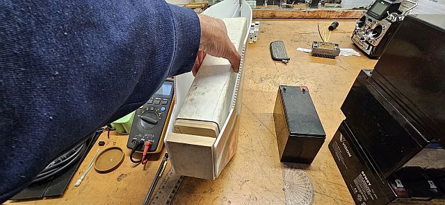

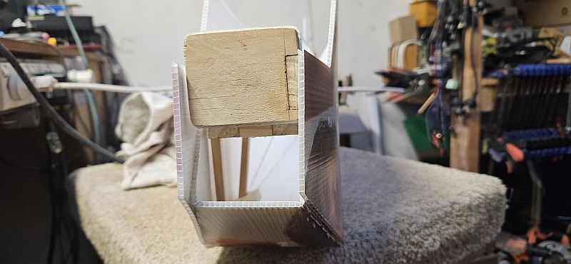

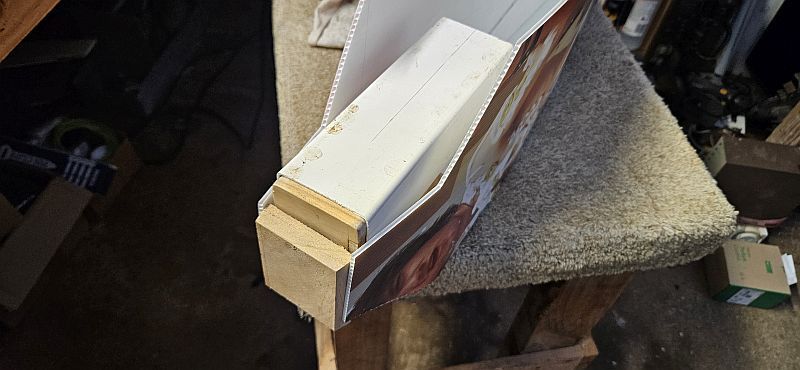

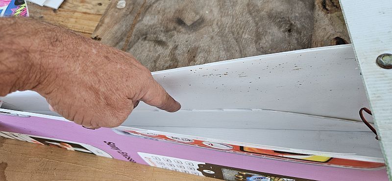

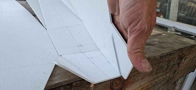

Well, the first fuse I cut with the flutes in the wrong direction, turns out I can't use. Made a mistake cutting the profile for the windscreen. So had to start again 🙄. The new one has the flutes in the right direction, and I could also implement a modification used in my original. Instead of cutting away the rear fuse pieces as per JJ's plan, Just cut the side profile and fold the remainder up to fit inside the fuse. This is glued and makes the whole thing quite rigid.
The same for the front end. It saves cutting and gluing fiddly bits of Coro....
The fuse is now all glued up.
And the tail feathers were well and truly skewered prior to sticking...

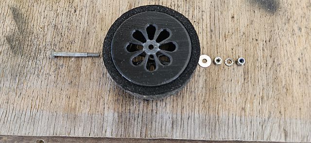

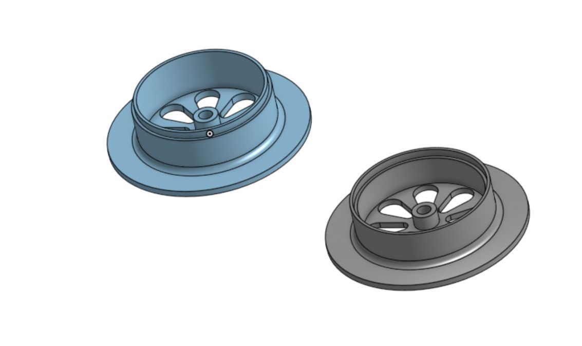

Wheels are also of course a consideration. The originals are good, but a bit small for the size of the plane. Some time ago I scored a bit of foam pipe insulation. About the right size for tires. Sketched up some rims and 3D printed them.
They turned out very useful, and the first set have done multiple landings without issue on the Dominator. Don't know if they would be all that good on seal, but our strip is grass.
The axles are made from 4" nails with an M4 thread cut at the end. No sign of bending even with several 'Arrivals' rather than landings 😁.

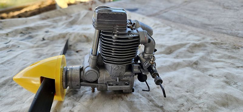

Will post the next update when progress continues, In the mean time, this is the before and after of the OS FS 48 Surpass which as mentioned does an excellent impersonation of a Swiss watch....
Cheers

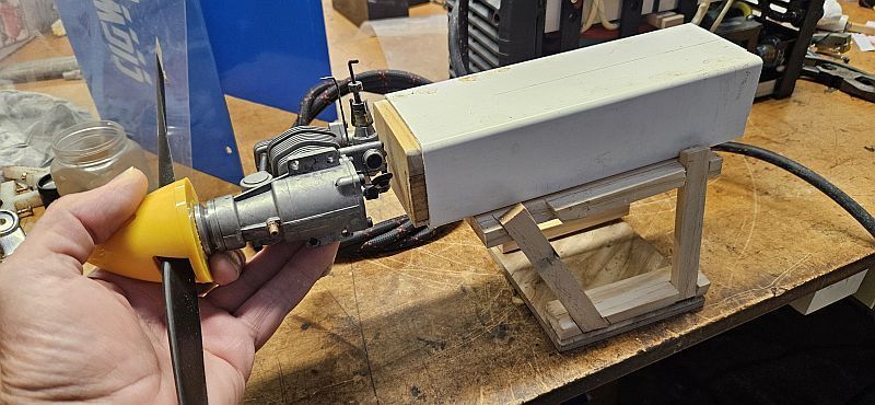

Unfortunately I haven't had time to do any more on the Cub. Although I'm retired, there seems to be less time now than when I was working 🫤. Something I've heard from other retired people. Did do a mock up of the engine support I'd like to use. Should work, but MAN what a pain trying to work out the angles for the braces 😳.

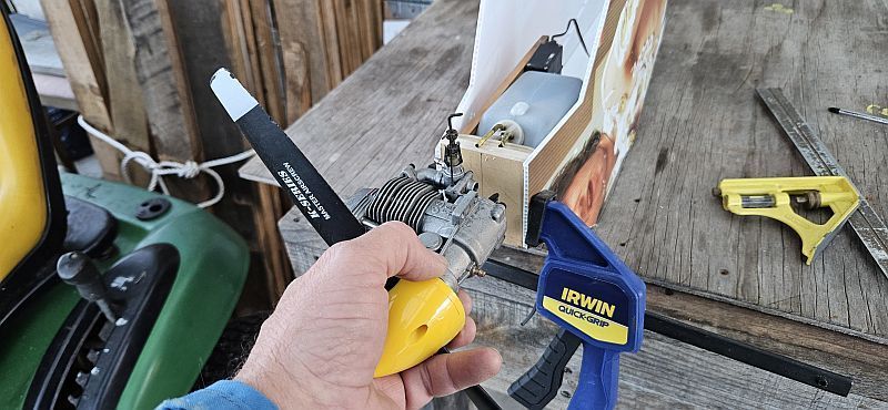

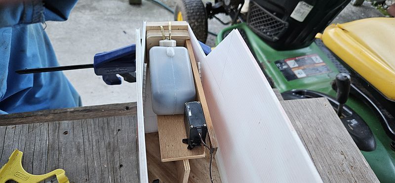

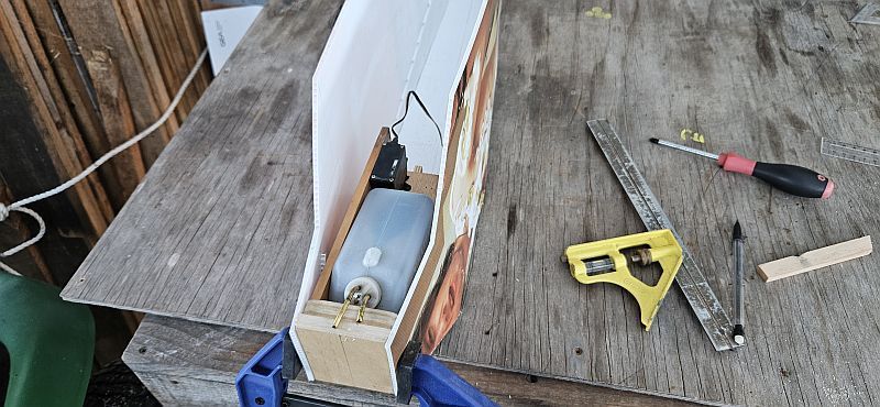

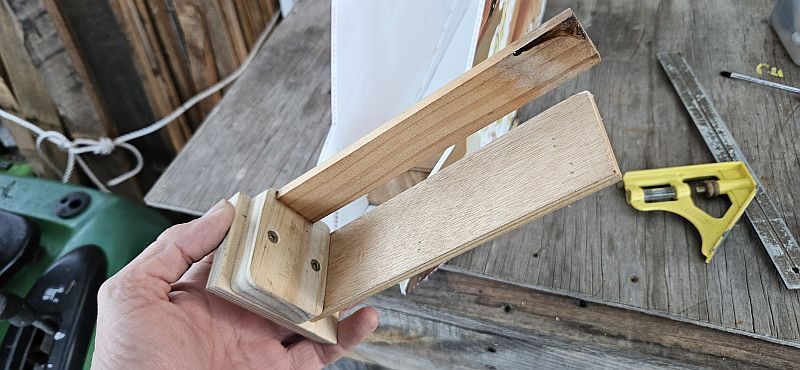

Finally got a bit of time today to continue with the Cub project. Decided to change the way the engine and associated bits are being mounted into the fuse. The drain pipe and stand was just going to be a pain not only to fit, but also dismantle if needed in the future. So it's now going to be like this...
Still more of a mockup at this point, but everything fits 🤗. Might only have one more day this week to continue, and then it's full on for a while. Back to the dairy plant I retired from to help a mate out with the winter maintenance 🙄. At lease I'll have access to their engineering shop should the Cub need a thing made. Always a silver lining 🙂.

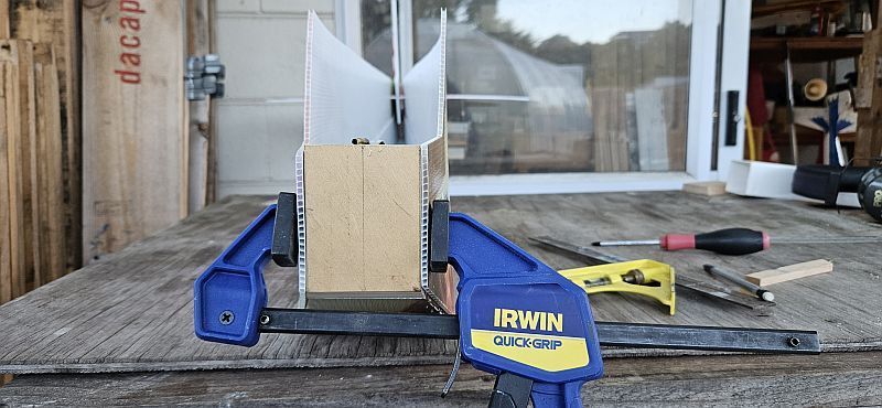

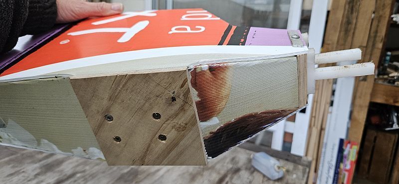

Small progress with the Cub as this winter maintenance lark continues at the dairy plant. Only a couple of weeks 🤞to go, then I can get back to retirement. Which I miss dearly 😁. Have finished up the engine mounting setup.
Hangs on with 4 screws up through the bottom which also clamps the inside and outside landing gear plate together....
Also managed to get the front wing mount made and installed.

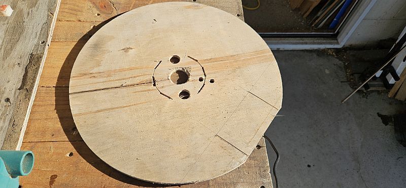

Found a great source of 5-ply for nix. Cable rolls use it for the ends, Of course it's about the same quality as pallet wood, but fine for models 😊.

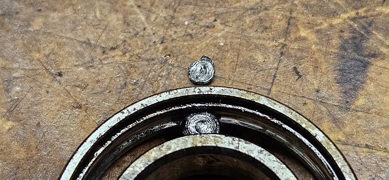

The last flight I had with the Dominator showed a resonance with the engine at idle. I'd heard it before in the past on other engines and something told me it was one of those 'Bad' noises 😳. After a flight I hit the engine cutoff switch and the engine stopped....Instantly. Turning the prop slowly by hand showed a jam up internally. Sure enough when I took the engine apart, the cause became obvious....
Yep, one of the balls had broken. Fortunately the bearing still had the shield on so the broken bit was contained. It was a fairly new bearing as the original had done the same thing, only that time the broken bits went up through the cylinder causing all the usual carnage on the way. Including gouging a line up the side of the cylinder. But it still had compression...sort of...so I fitted new bearings to the old ASP46. Didn't notice the cylinder damage until the new ones were being fitted 🙄. But it ran well. Another new bearing has been fitted and it runs fine, but haven't had a chance to air test it due to work and weather. But not long now 🤞😁.
