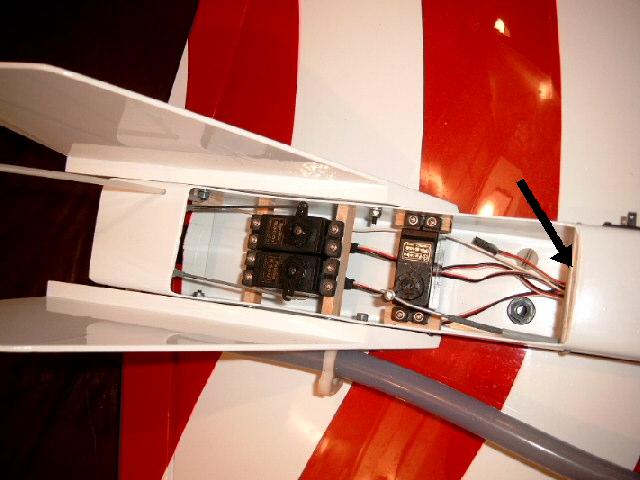

Menards is .050-Mills Fleet Farm is .070 (Genova is the brand)
I found the Menards very flexable-I had to add a former to the Menard's stuff to keep it from twisting at the rear cutout on my Gremlin. The Fleet Farm stuff does not flex.
I used the .070 on my SPAD DPS-it is very stiff. No tortional twisting.
