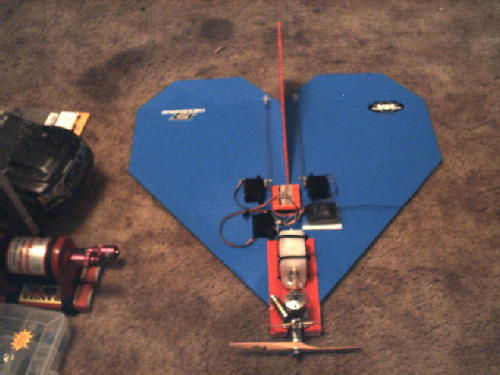

need help have a delta wing spad plan with no instructions or CG placement need to know where the CG of this plane is.
It's a flat wing design delta wing for a .10-.25 engine
wing spans is 24" and length is 24" anyone know would be greatly apprieciated.
thanks guys

the sweep is 11.5, root cord is 19, tip cord 6.75 half span 11.75
i didn't buy if from a website i got it from the anual swap meet were venders bring stuff to sell.
these are the exact dimensions. not including the elevons.

here it is maybe this will help.

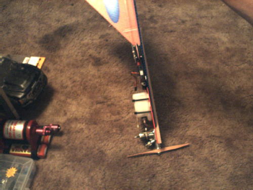

side veiw

a normal pbf would balance at 22% mac, but, i am not sure what to tell you about that one. Incidentally, you include the elevons in the equation. I think i'd start at 22% back from the leading edge, and just move it back from there, as need be.

The CG on your delta is 9" from the front of your engine mount. Or 7" from where the coro starts. Boogerboy!
