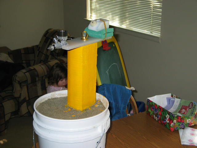

During construction of my SSC HOR, I was inspired! 40 pounds of cement later...

I used WalMart chopping board, a 3.5 gallon bucket (?), 4 oz fuel tank, 3x4 Rail Road tie, 1/2 in threaded rod and brass wing nut/washer. I epoxied the rod into the wood.
You can also turn the board around for another size engine!
There are also 2 layers of styrofoam packing peanuts to take up volume and same weight. I never know what to do with them things...

The only way to get this thing to fly is to throw it off of the roof!

I did it this way since I am either in a Townhouse or Apartment, depending on what city I am in. This is very portable, unless 40 pounds of cement is a little much.

Just a note about vibration. There was some when the Norvel .15 was around 7,000 to 12,000 rpm. It was smoooooth at 17,000! I would either use another bolt to hold it to the wood, or move the hole closer to the engine.
Other than that, it was a great thing to use today!
