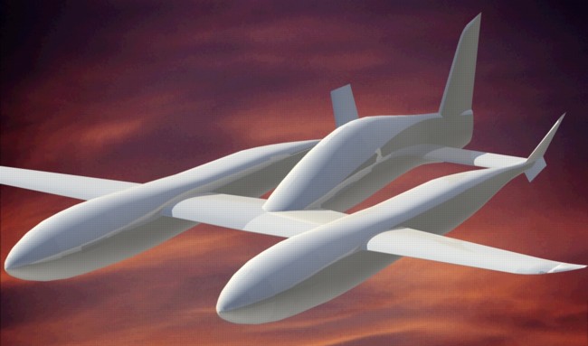

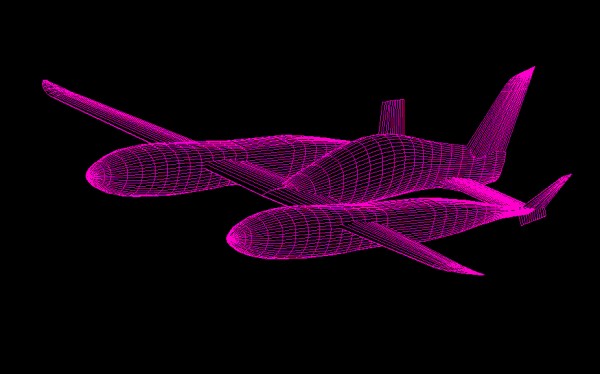

So for some of you gurus out there, what can be done with this computer rendering as far as dimensions for foam plugs.
P.S. I don't want to seem pretentious.
I'd like to hear from non-gurus too!

Here's another.
Please lead the way.
Is it possible to scan this and have it dimensioned?

Do you have the files that created those rederings?

Default Pond Racer
No.
I found these pictures on this forum.

Default Pond Racer
Contact the person who drew it up ... he may be willing to share the source file(s).

Default Pond Racer
You may also want to check the RC CAD web site ... I think I saw this one on there as an example of someone's work ... You may be able to download the files ... And you can download a limited version of RC CAD.

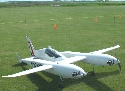

The SWRA allows the Pond Racer because it raced at Reno.
You can see a model that raced in SWRA here
Tucson Race with Pond Racer

Can anyone from the Tucson area tell me anything about the Pond Racer that PJ-TankPilot posted.

>>tell me anything about the Pond Racer ...
Send a message to jetjockey
The Pond Racer in the pictures is his.

Default RE: Pond Racer
I have scaled 3 views of the pond racer.. i wouldn't go from this drawing.. to hard to guestimate. I once made a 1/20 scale model of the pond racer it's a really kewl ship. It's really to bad that they didn't build another, it really was a fluke it crashed.. carbon monoxide poisoning I believe it was from one of the engines leaked into the cockpit, and it made the pilot pass out, and the ship rolled over and right in.
