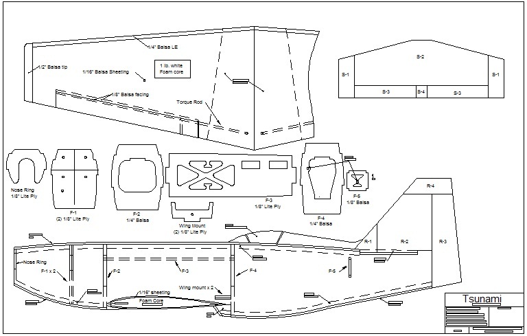

Hey Jake,
It would be nice to see you again. The 1/12 scale stuff has fizzled a bit lately so some extra participation would be great. Let me know if you need anything.
Here is the Tsunami I built for this season.

Red the tsunami looks great. What is it about 100". Lol look at the perspective with people in the back ground. The table looks like it's turf on the ground.
Tim

Tim,
The forced perspective does make it look huge doesn't it....I never noticed that before! It's a bit on the small side actually, only 29" span and 165 sq. in with a O.S. .30 [X(] Lotsa fun in a small package. BTW...it has a 6060 at the root and 6062 at the tip.
