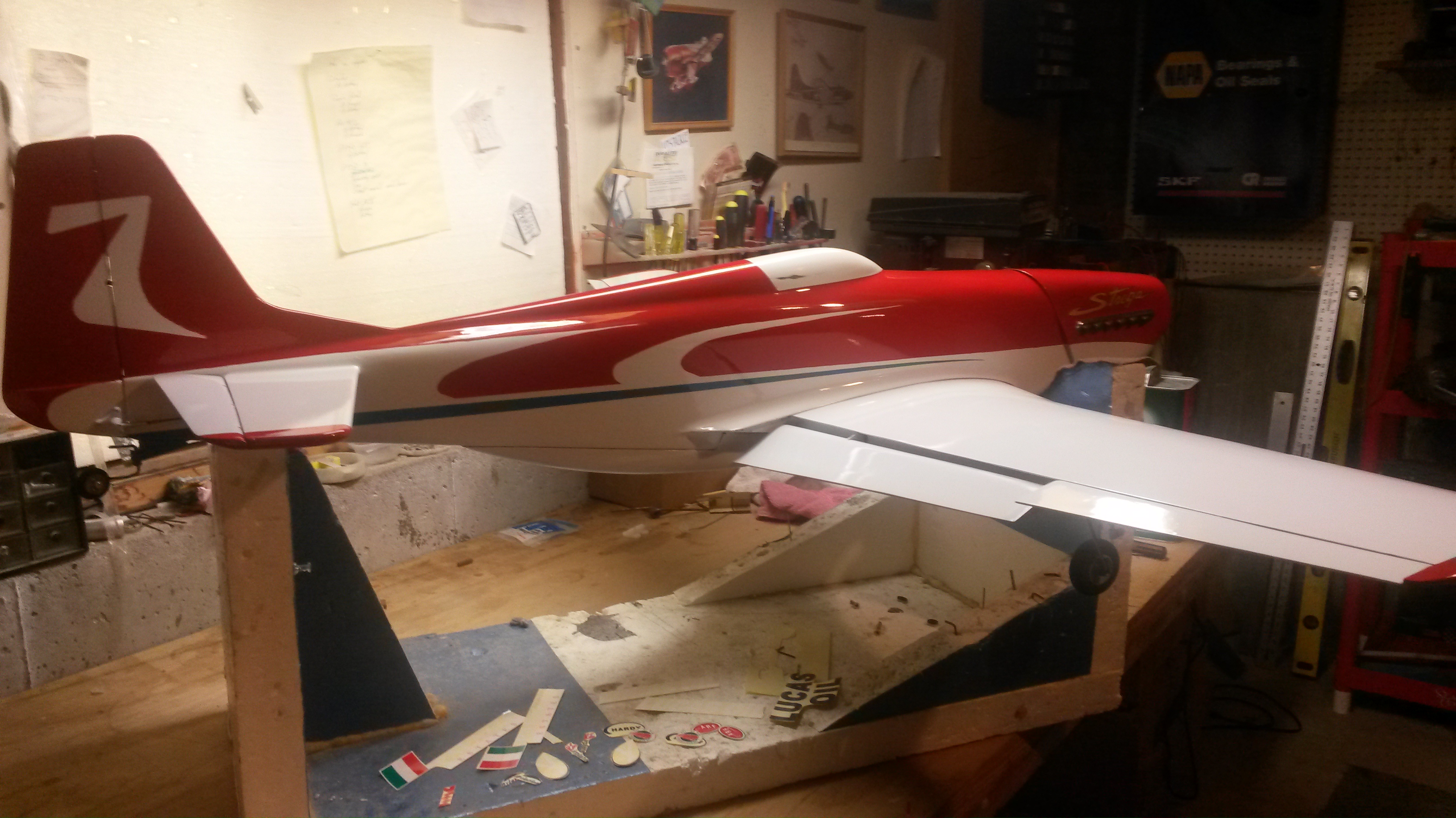

I replaced the spring gear with a set hobby kink struts, The landing were very hard not to bounce the plane hard. We also put flaps on her, this is a heavy 40 size plane that moves out with the ys.
Ron

Story on the Strega, We stripped it down, glassed with .5 oz fiberglass cloth and then painted with automotive paint. The engine is a ys 1.15 warbird special, running 30% fuel, that is the minimum YS recommends. Have only flown with a 14x11 apc, but have a 14x12, 14x13 and a 13.5x 13.5. Will try the other props in about 3 week. The 14x11 turns about 10,500 on the ground and really move the plane, radar is about 120, vertical is unlimited. The plane weighs 8.5#s. this isn't a typical 40 size plane it is built to handle the ys racing engine. That is why I decided to add the flaps, really just carrying the 2 extra servos. The plane flies like its on a string no bad habits but landing is a chore, better not get to slow even with the flaps she eats up the runway. In California a gentleman is pushing this plane up to 200 mph with 60% fuel and a 14x16 apc prop. Sure he has to slow down to race that plane.
Ron
